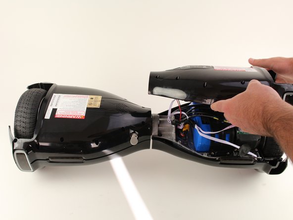

  3. Hover-1 H1 Power Button  Replacement: crwdns2935265:03crwdnd2935265:01crwdnd2935265:02crwdne2935265:0 Hover-1 H1 Power Button  Replacement: crwdns2935265:03crwdnd2935265:02crwdnd2935265:02crwdne2935265:0
    • Lift each side of the bottom shell by pulling up.
    • When lifting the shell, take care to not tear any cables from their connectors.

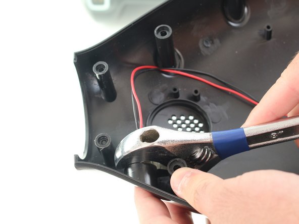

  6. Hover-1 H1 Power Button  Replacement: crwdns2935265:06crwdnd2935265:01crwdnd2935265:02crwdne2935265:0 Hover-1 H1 Power Button  Replacement: crwdns2935265:06crwdnd2935265:02crwdnd2935265:02crwdne2935265:0
    • Using an adjustable wrench, remove the nut on the back of the power button by rotating the nut counterclockwise.
