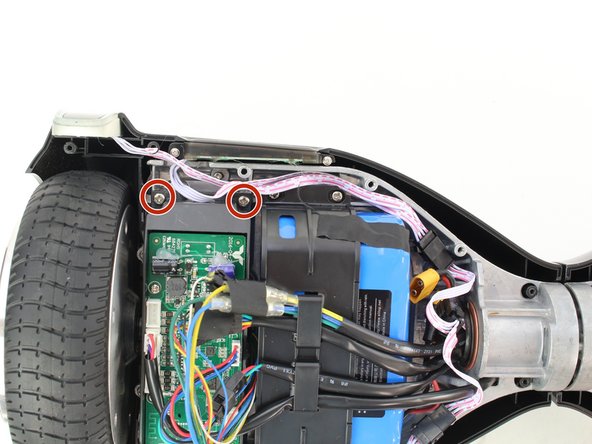

  2. Hover-1 H1 Gyroscope Sensor Assemblies Replacement: crwdns2935265:02crwdnd2935265:01crwdnd2935265:01crwdne2935265:0
    • Puncture the two black stickers by using the tip of a screwdriver.
    • Remove the two 9mm machine screws by using a long Phillips #2 screwdriver to rotate the screws counterclockwise.

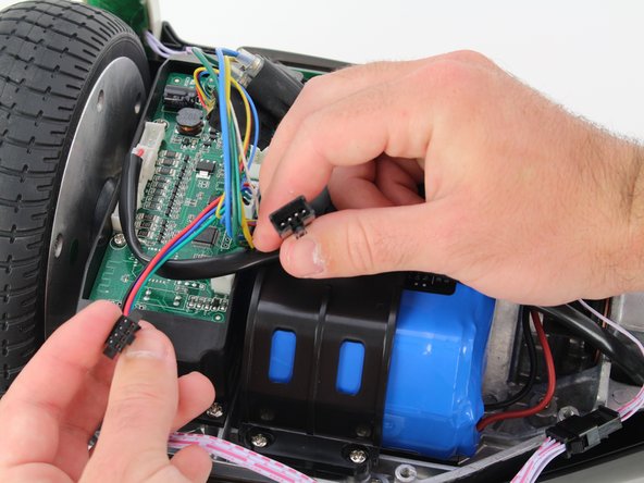

    • On the battery side of the hoverboard, remove the red, black, and purple sleeved cable from the sensor assembly by squeezing the tab and pulling up.
  6. Hover-1 H1 Gyroscope Sensor Assemblies Replacement: crwdns2935265:06crwdnd2935265:01crwdnd2935265:02crwdne2935265:0 Hover-1 H1 Gyroscope Sensor Assemblies Replacement: crwdns2935265:06crwdnd2935265:02crwdnd2935265:02crwdne2935265:0

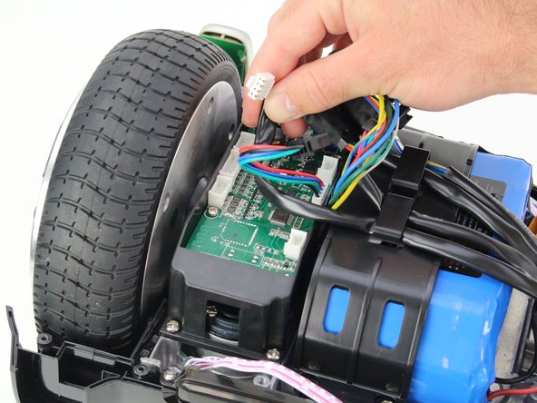

    • Remove the red, blue, and green cable from the cable extension connected to the sensor assembly by squeezing the tabs on the side of the connector.

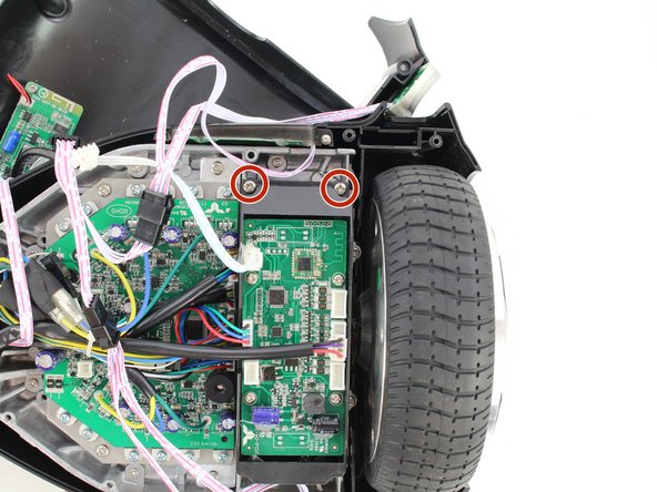

    • Remove the four 7mm screws by using a Phillips #2 screwdriver to rotate the screws counterclockwise.
  8. Hover-1 H1 Gyroscope Sensor Assemblies Replacement: crwdns2935265:08crwdnd2935265:01crwdnd2935265:01crwdne2935265:0
    • Remove the sensor assembly on the battery side of the hoverboard by gently lifting and pulling away from the hoverboard.

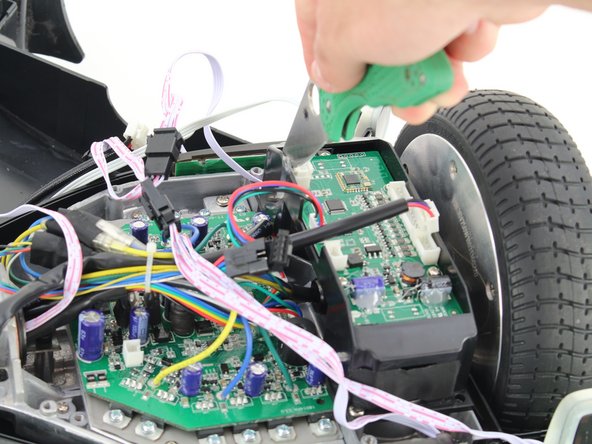

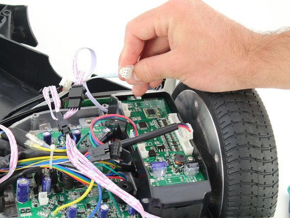

    • Remove the hot glue holding in the connectors with a utility knife.
    • Remove the white cable from the sensor assembly by squeezing the connector and pulling the connector up.
    • Be careful not to touch any parts of the circuit boards with the knife.

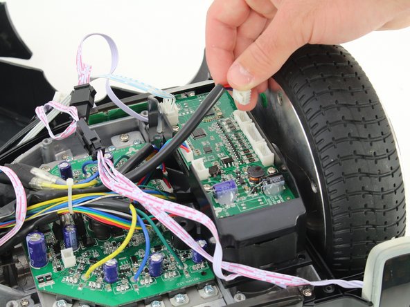

    • Remove the red, blue, and green cable from the extension connected to the sensor assembly by squeezing the tabs on the side of the connector.
  11. Hover-1 H1 Gyroscope Sensor Assemblies Replacement: crwdns2935265:011crwdnd2935265:01crwdnd2935265:02crwdne2935265:0 Hover-1 H1 Gyroscope Sensor Assemblies Replacement: crwdns2935265:011crwdnd2935265:02crwdnd2935265:02crwdne2935265:0
    • Remove the red and black sleeved connector from the sensor assembly by squeezing the tab and pulling up.
