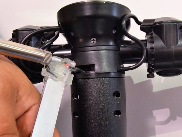

  3. Hover-1 Folding E-Scooter LED Headlight Replacement: crwdns2935265:03crwdnd2935265:01crwdnd2935265:02crwdne2935265:0 Hover-1 Folding E-Scooter LED Headlight Replacement: crwdns2935265:03crwdnd2935265:02crwdnd2935265:02crwdne2935265:0
    • Disconnect the red wire using a soldering iron.
    • The soldering iron should melt the glue for you, so don't worry about removing it yourself.
  4. Hover-1 Folding E-Scooter LED Headlight Replacement: crwdns2935265:04crwdnd2935265:01crwdnd2935265:01crwdne2935265:0
    • For ease of installation, tin your new LED and the connecting wire with the soldering iron and solder.
    • Solder your new light on to the existing red wire.
    • For help on how to solder, refer to iFixit's Soldering Guide.
