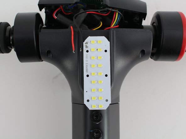

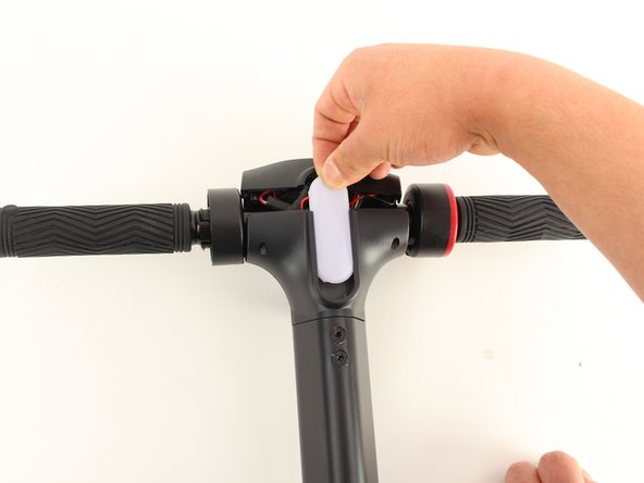

      • Slide the LED light cover upwards out of the display housing
      • Be gentle when removing the LED light cover to avoid damaging the LED's connecting wires.
      • The LED circuit board should slide out with the LED light cover.
      • To reassemble, align the prongs of the LED cover with the holes in the LED circuit board.

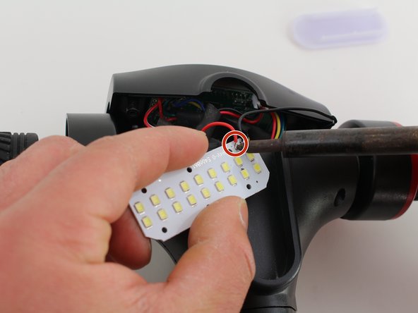

    4. Hover-1 Eagle LED Headlight Replacement: crwdns2935265:04crwdnd2935265:01crwdnd2935265:03crwdne2935265:0 Hover-1 Eagle LED Headlight Replacement: crwdns2935265:04crwdnd2935265:02crwdnd2935265:03crwdne2935265:0 Hover-1 Eagle LED Headlight Replacement: crwdns2935265:04crwdnd2935265:03crwdnd2935265:03crwdne2935265:0
      • Using a soldering iron, desolder the black and red wires from the LED circuit board.
      • To reassemble, solder the same black and red wires onto the new LED circuit board.
