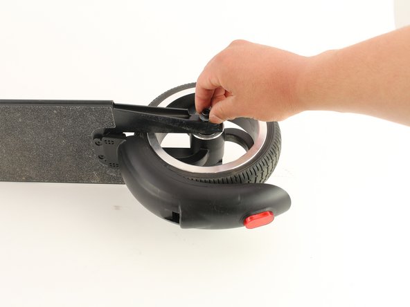

      • Peel off the reflective red axle sticker using a plastic spudger.
    2. Hover-1 Eagle Back Wheel Replacement: crwdns2935265:02crwdnd2935265:01crwdnd2935265:01crwdne2935265:0
      • Use a Phillips #2 screwdriver to remove the 2mm screw located underneath the reflective sticker.

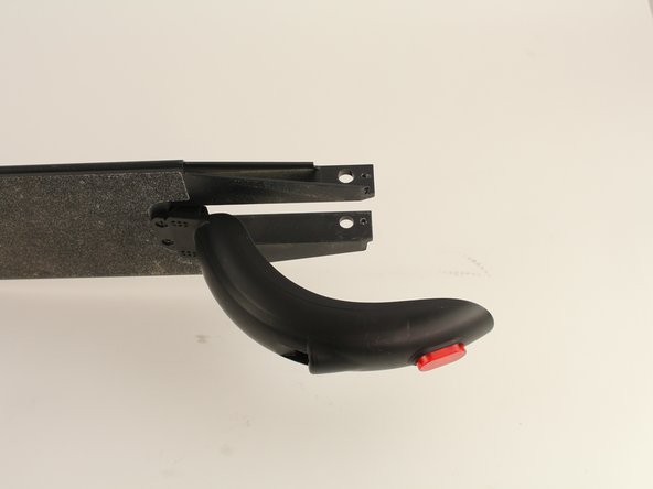

      • Grip the deck flare and slide it towards the tail end of the scooter.

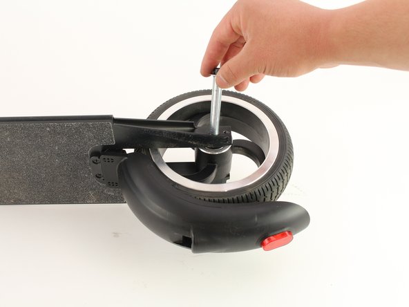

      • Remove the 6 mm axle screws by using a hex bit 5.0.
      • Make sure to try loosening both sides. One of the axle screws spins freely and will not loosen.
    5. Hover-1 Eagle Back Wheel Replacement: crwdns2935265:05crwdnd2935265:01crwdnd2935265:03crwdne2935265:0 Hover-1 Eagle Back Wheel Replacement: crwdns2935265:05crwdnd2935265:02crwdnd2935265:03crwdne2935265:0 Hover-1 Eagle Back Wheel Replacement: crwdns2935265:05crwdnd2935265:03crwdnd2935265:03crwdne2935265:0
      • Repeat Steps 1-3 for the other side.
      • Apply pressure to the axle using a hex bit 5.0 to push it slightly out on the other side.
      • Take hold of the 6 mm axle screw on the opposite side and remove the axle by pulling firmly towards you.

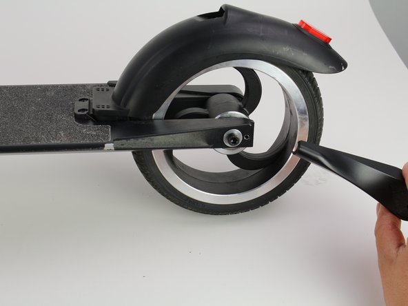

    6. Hover-1 Eagle Back Wheel Replacement: crwdns2935265:06crwdnd2935265:01crwdnd2935265:02crwdne2935265:0 Hover-1 Eagle Back Wheel Replacement: crwdns2935265:06crwdnd2935265:02crwdnd2935265:02crwdne2935265:0
      • Pull backwards to remove the back wheel.
      • Washers may fall when the wheel is removed, so make sure to catch or gather the washers.
