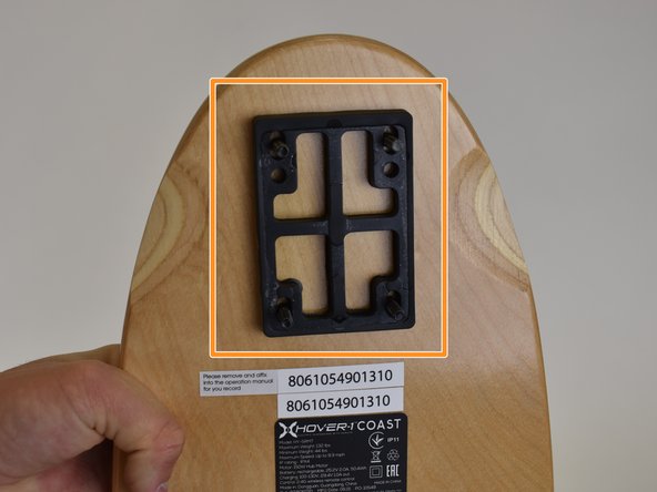

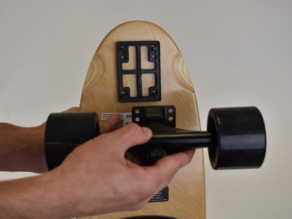

  3. Hover-1 Coast Trucks Replacement: crwdns2935265:03crwdnd2935265:01crwdnd2935265:03crwdne2935265:0 Hover-1 Coast Trucks Replacement: crwdns2935265:03crwdnd2935265:02crwdnd2935265:03crwdne2935265:0 Hover-1 Coast Trucks Replacement: crwdns2935265:03crwdnd2935265:03crwdnd2935265:03crwdne2935265:0
    • Remove the nuts from the bottom of the board.
    • Slide the unwanted trucks off the screws.
    • The black rubber spacer will stay on the board.
