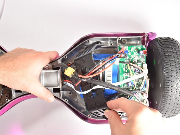

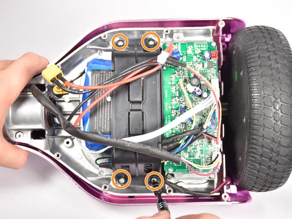

    • Free the cables held atop the bracket holding the battery in place.
    • Remove the four 14 mm Phillips #2 screws holding the battery bracket in place.
    • Pull the battery bracket free.
