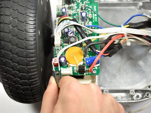

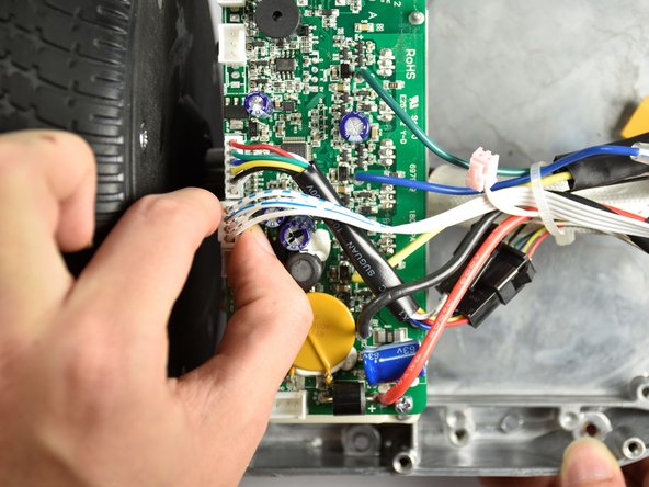

  4. Hover-1 Chrome Left Gyroscope Sensor Board Replacement, Left Gyroscope Sensor Board: crwdns2935265:04crwdnd2935265:01crwdnd2935265:03crwdne2935265:0 Hover-1 Chrome Left Gyroscope Sensor Board Replacement, Left Gyroscope Sensor Board: crwdns2935265:04crwdnd2935265:02crwdnd2935265:03crwdne2935265:0 Hover-1 Chrome Left Gyroscope Sensor Board Replacement, Left Gyroscope Sensor Board: crwdns2935265:04crwdnd2935265:03crwdnd2935265:03crwdne2935265:0
    • Disconnect the speaker cable.
    • Disconnect the cable that travels to the other sensor board.

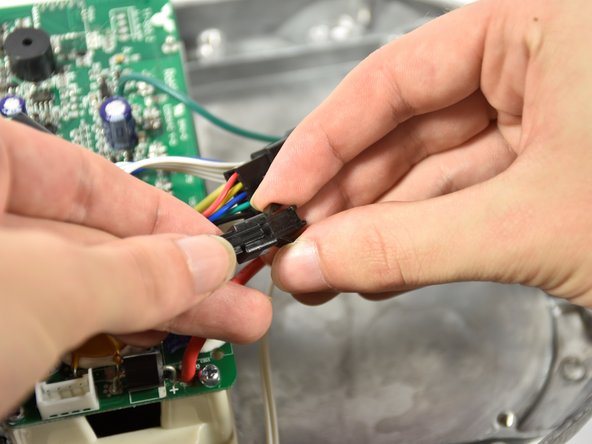

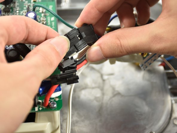

  5. Hover-1 Chrome Left Gyroscope Sensor Board Replacement: crwdns2935265:05crwdnd2935265:01crwdnd2935265:03crwdne2935265:0 Hover-1 Chrome Left Gyroscope Sensor Board Replacement: crwdns2935265:05crwdnd2935265:02crwdnd2935265:03crwdne2935265:0 Hover-1 Chrome Left Gyroscope Sensor Board Replacement: crwdns2935265:05crwdnd2935265:03crwdnd2935265:03crwdne2935265:0
    • Disconnect the smaller connector midway on the cable.
    • Disconnect the larger connector midway on the cable.

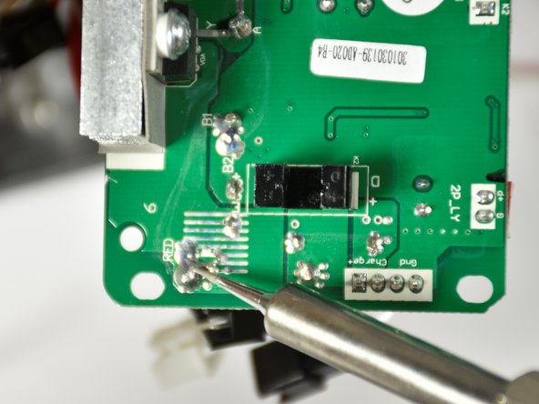

  7. Hover-1 Chrome Left Gyroscope Sensor Board Replacement: crwdns2935265:07crwdnd2935265:01crwdnd2935265:02crwdne2935265:0 Hover-1 Chrome Left Gyroscope Sensor Board Replacement: crwdns2935265:07crwdnd2935265:02crwdnd2935265:02crwdne2935265:0
    • Locate the five solder locations on the underside of the gyroscope sensor board.
    • Plug in soldering iron and wait for the tip tip to reach its target temperature.
    • Rest the tip of the iron on the solder and wait for the solder to melt. The wire will drop out of the sensor board.
    • Be aware of where the tip of the soldering iron is at ALL times. Put on safety glasses before picking up the soldering iron. Turn on a fan and face it towards the device to vent harmful fumes away from the solderers face.
