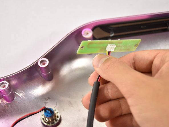

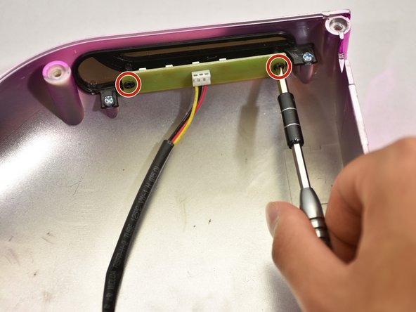

  4. Hover-1 Chrome LED Headlights Replacement, LED Headlights: crwdns2935265:04crwdnd2935265:01crwdnd2935265:03crwdne2935265:0 Hover-1 Chrome LED Headlights Replacement, LED Headlights: crwdns2935265:04crwdnd2935265:02crwdnd2935265:03crwdne2935265:0 Hover-1 Chrome LED Headlights Replacement, LED Headlights: crwdns2935265:04crwdnd2935265:03crwdnd2935265:03crwdne2935265:0
    • Use a Phillips #2 screwdriver to remove the two 2 mm screws on either side of the LEDs.
    • Remove the LED board.
    • The LEDs are not symmetrical. This step is for the right side of the board, next to the power button. The left side is covered next.

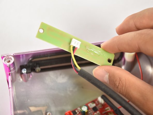

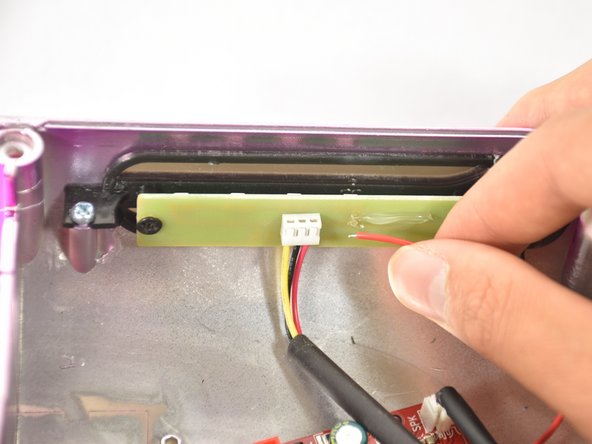

  5. Hover-1 Chrome LED Headlights Replacement: crwdns2935265:05crwdnd2935265:01crwdnd2935265:02crwdne2935265:0 Hover-1 Chrome LED Headlights Replacement: crwdns2935265:05crwdnd2935265:02crwdnd2935265:02crwdne2935265:0
    • Locate the LED headlights on the left side of the board.
    • Pull the red wire attached to the LEDs perpendicular to the other wires to disconnect it.

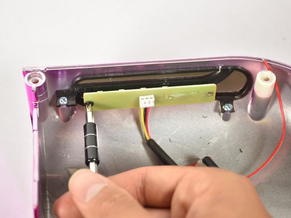

  6. Hover-1 Chrome LED Headlights Replacement: crwdns2935265:06crwdnd2935265:01crwdnd2935265:03crwdne2935265:0 Hover-1 Chrome LED Headlights Replacement: crwdns2935265:06crwdnd2935265:02crwdnd2935265:03crwdne2935265:0 Hover-1 Chrome LED Headlights Replacement: crwdns2935265:06crwdnd2935265:03crwdnd2935265:03crwdne2935265:0
