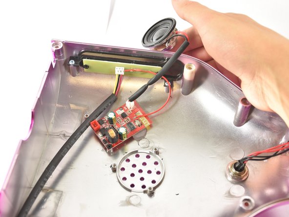

    • Lift the shell without the speaker grille and unplug the battery.
  3. Hover-1 Chrome Bluetooth Speaker Replacement: crwdns2935265:03crwdnd2935265:01crwdnd2935265:01crwdne2935265:0

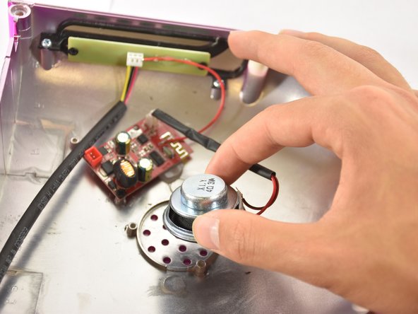

    • Lift the shell with the speaker grille so the speaker can be accessed.
    • Remove the three 14 mm Phillips #2 screws holding the speaker to the bottom left shell.
  4. Hover-1 Chrome Bluetooth Speaker Replacement: crwdns2935265:04crwdnd2935265:01crwdnd2935265:03crwdne2935265:0 Hover-1 Chrome Bluetooth Speaker Replacement: crwdns2935265:04crwdnd2935265:02crwdnd2935265:03crwdne2935265:0 Hover-1 Chrome Bluetooth Speaker Replacement: crwdns2935265:04crwdnd2935265:03crwdnd2935265:03crwdne2935265:0
    • Pull off the bracket holding the speaker in place.
    • Place the speaker to the side so that the tab on the cable connector to the sound card can be accessed.

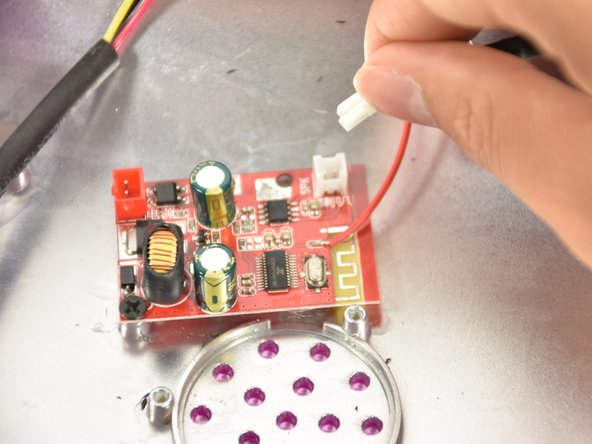

  5. Hover-1 Chrome Bluetooth Speaker Replacement: crwdns2935265:05crwdnd2935265:01crwdnd2935265:02crwdne2935265:0 Hover-1 Chrome Bluetooth Speaker Replacement: crwdns2935265:05crwdnd2935265:02crwdnd2935265:02crwdne2935265:0
    • Disconnect the cable attaching the speaker to the sound card.
