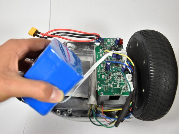

  4. Hover-1 Chrome Battery Replacement, Battery: crwdns2935265:04crwdnd2935265:01crwdnd2935265:01crwdne2935265:0
    • Place the metal spudger end between the blue battery and the adhesive pad that attaches it to the metal body.
    • Use the metal spudger only as a last resort if the adhesive is too strong for either your hands or other plastic prying tools.
    • Use the spudger to pry the battery loose from the adhesive.
  5. Hover-1 Chrome Battery Replacement: crwdns2935265:05crwdnd2935265:01crwdnd2935265:02crwdne2935265:0 Hover-1 Chrome Battery Replacement: crwdns2935265:05crwdnd2935265:02crwdnd2935265:02crwdne2935265:0
    • Pull and wiggle the battery completely off of the adhesive using your hands.
    • Remove the battery from the body.
