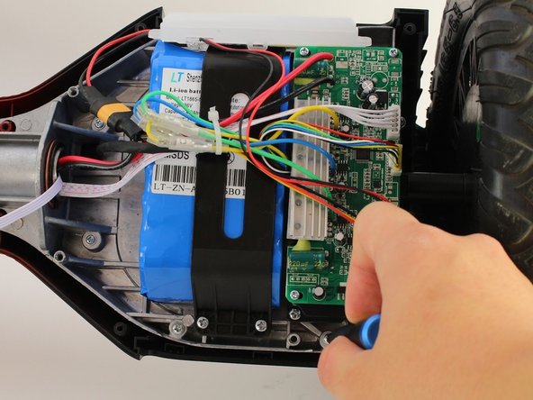

    • Flip the hoverboard over so that the warning label is facing up.
    • Remove the twelve 12 mm screws with a Phillips #2 screwdriver.
    • Remove the four 10 mm screws with a Phillips #2 screwdriver.
    • The screws nearest to the wheels may be hard to access. Be sure to use a long, thin screwdriver.

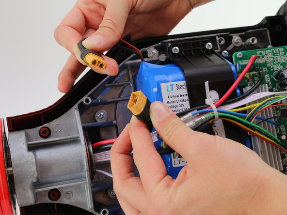

  4. Hover-1 Charger Outer Shell Replacement: crwdns2935265:04crwdnd2935265:01crwdnd2935265:02crwdne2935265:0 Hover-1 Charger Outer Shell Replacement: crwdns2935265:04crwdnd2935265:02crwdnd2935265:02crwdne2935265:0

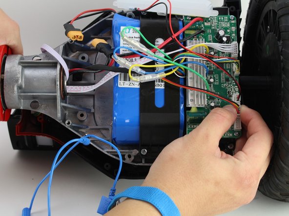

    • Unplug the battery by disconnecting the two pronged black and yellow cable.

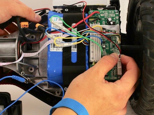

  5. Hover-1 Charger Outer Shell Replacement: crwdns2935265:05crwdnd2935265:01crwdnd2935265:03crwdne2935265:0 Hover-1 Charger Outer Shell Replacement: crwdns2935265:05crwdnd2935265:02crwdnd2935265:03crwdne2935265:0 Hover-1 Charger Outer Shell Replacement: crwdns2935265:05crwdnd2935265:03crwdnd2935265:03crwdne2935265:0
    • Unplug the black, yellow, green and red four pin connector from the circuit board.
    • Unplug the red and black two pin connector from the circuit board.

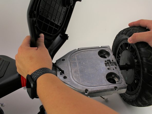

  6. Hover-1 Charger Outer Shell Replacement: crwdns2935265:06crwdnd2935265:01crwdnd2935265:02crwdne2935265:0 Hover-1 Charger Outer Shell Replacement: crwdns2935265:06crwdnd2935265:02crwdnd2935265:02crwdne2935265:0
    • Thread the black, yellow, green, and red four pin connector through the opening to the left of the battery.
    • Remove the right foot pad from the hoverboard.

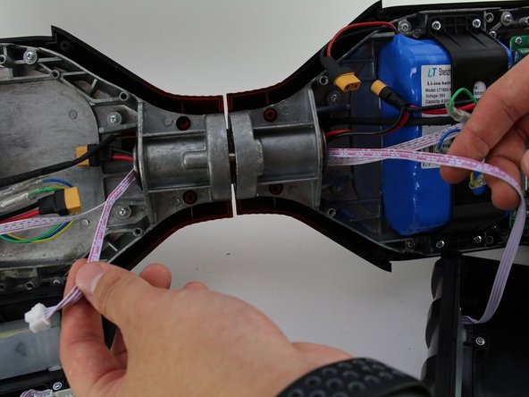

  7. Hover-1 Charger Outer Shell Replacement: crwdns2935265:07crwdnd2935265:01crwdnd2935265:01crwdne2935265:0
    • Pull the left cover away from the hoverboard.
  8. Hover-1 Charger Outer Shell Replacement: crwdns2935265:08crwdnd2935265:01crwdnd2935265:02crwdne2935265:0 Hover-1 Charger Outer Shell Replacement: crwdns2935265:08crwdnd2935265:02crwdnd2935265:02crwdne2935265:0
    • Unplug the red and white five pin connector from the circuit board.
    • Thread this connector through the middle cylinder.
    • Remove the right cover from the hoverboard.

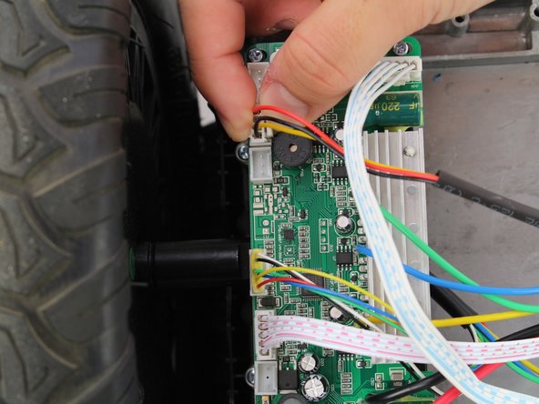

  9. Hover-1 Charger Outer Shell Replacement: crwdns2935265:09crwdnd2935265:01crwdnd2935265:02crwdne2935265:0 Hover-1 Charger Outer Shell Replacement: crwdns2935265:09crwdnd2935265:02crwdnd2935265:02crwdne2935265:0

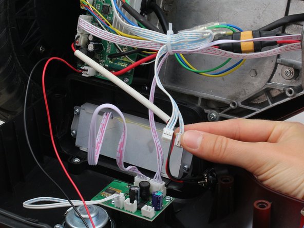

    • Unplug the red and white four pin connector from the speaker circuit board.
    • Unplug the blue and white three pin connector.
    • Unplug the blue and white two pin connector. This is photographed as an example.

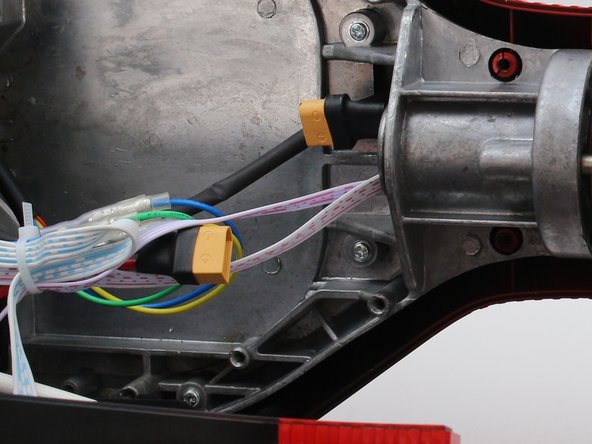

    • Disconnect the two pronged black and yellow cable.

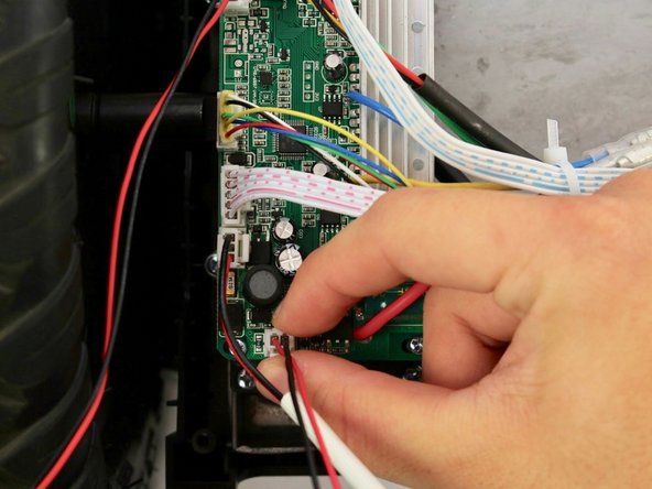

    • Remove three black and red two pin connectors from the left circuit board.
    • Remove the red, yellow, and black three pin connector.
    • Remove zip tie if present.
