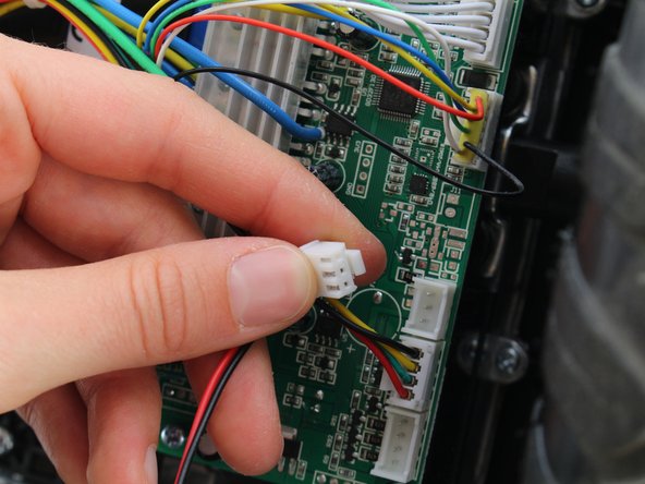

  6. Hover-1 Charger LED Headlight Replacement, LED Headlight: crwdns2935265:06crwdnd2935265:01crwdnd2935265:02crwdne2935265:0 Hover-1 Charger LED Headlight Replacement, LED Headlight: crwdns2935265:06crwdnd2935265:02crwdnd2935265:02crwdne2935265:0
    • Remove the black and red two pin connector from the circuitboard.

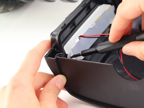

  7. Hover-1 Charger LED Headlight Replacement: crwdns2935265:07crwdnd2935265:01crwdnd2935265:02crwdne2935265:0 Hover-1 Charger LED Headlight Replacement: crwdns2935265:07crwdnd2935265:02crwdnd2935265:02crwdne2935265:0
    • Remove the two 12mm screws holding the LED to the front cover with a Phillips #2 screwdriver.
    • Our Hoverboard was missing a screw in the LED housing. Yours may or may not be missing screws as well.
  8. Hover-1 Charger LED Headlight Replacement: crwdns2935265:08crwdnd2935265:01crwdnd2935265:01crwdne2935265:0
    • With the wire unplugged and screws removed, you can now safely seperate the LED from the Hoverboard.
