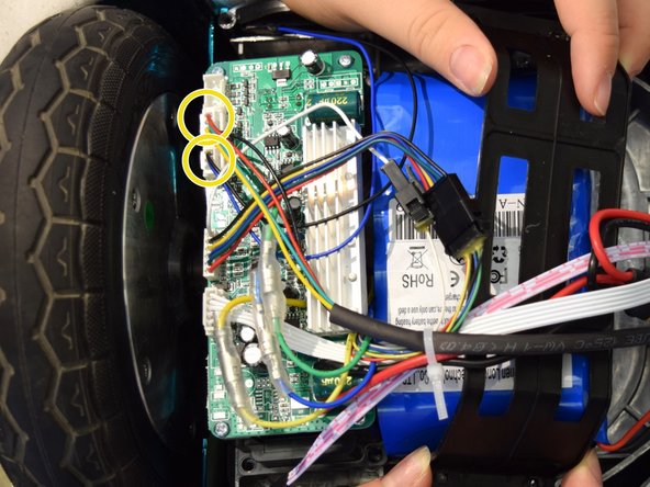

    • On the bottom plug side shell pieces, there are two white and pink wires connecting the shell and the motherboard.
    • On the circuit board by the speaker, carefully squeeze and unplug the small white headers that connect the shell piece to the hoverboard body.
    • Follow the wires that connect the lights to the motherboard. Disconnect these wires from the motherboard by squeezing and pulling the small white headers.
    • Now you can fully remove the bottom plug side shell piece.

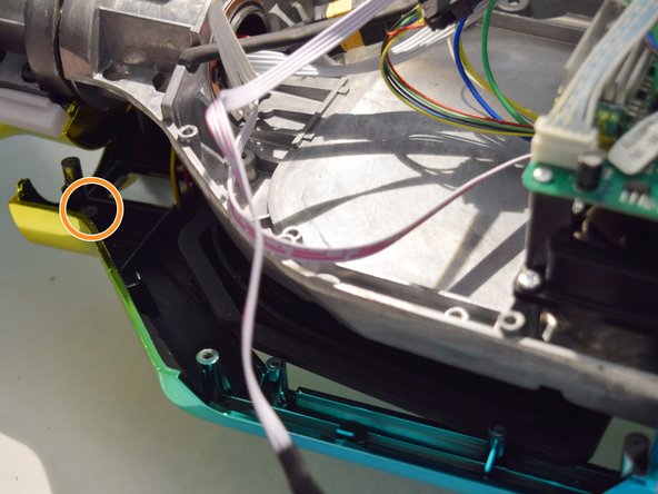

    • Push down the shell and LED light near the center of the board as shown.
    • In the newly exposed area, there will be an 11mm screw holding in the wire that connects to the LED light of the frame. Remove this screw.
    • Now separate the light from the shell and board.
    • Repeat this for the other 3 lights.

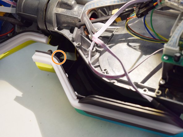

  6. Hover 1 Eclipse Shell Replacement: crwdns2935265:06crwdnd2935265:01crwdnd2935265:02crwdne2935265:0 Hover 1 Eclipse Shell Replacement: crwdns2935265:06crwdnd2935265:02crwdnd2935265:02crwdne2935265:0
    • Follow the rainbow cord that connects the left side shell piece to the inside board. Find where it is plugged into and disconnect it.
    • The cord is a bundle of multicolored wires sheathed in black, halfway down.
    • Follow the black and blue cord that connects the left side shell piece to the inside board. Find where it is plugged into and disconnect it.
    • Repeat for the top right shell piece.
    • Remove both shell pieces.
