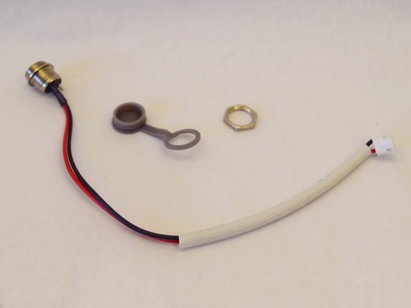

    • Using a Phillips #1 Screwdriver, remove the four 11mm screws that surround the edge of the left side bottom shell piece.
    • Using a Phillips #1 Screwdriver, remove the four 13mm screws that surround the edge of the left side bottom shell piece.
    • The order and placement of the 2 types of screws is mirrored for both sides of the bottom shell.
    • Pull back and set aside the left bottom shell halve. This shell half is still wired to rest of the hoverboard.
  2. Hover 1 Eclipse Charging Port Replacement: crwdns2935265:02crwdnd2935265:01crwdnd2935265:01crwdne2935265:0
    • Unscrew the ring around the inside section of the charging port.
  3. Hover 1 Eclipse Charging Port Replacement: crwdns2935265:03crwdnd2935265:01crwdnd2935265:01crwdne2935265:0
    • Follow the wire back from the charging port to where it plugs into the board.
    • Unplug the wire from the board, and pull it through the ring you previously unscrewed from the charging port.
  4. Hover 1 Eclipse Charging Port Replacement: crwdns2935265:04crwdnd2935265:01crwdnd2935265:02crwdne2935265:0 Hover 1 Eclipse Charging Port Replacement: crwdns2935265:04crwdnd2935265:02crwdnd2935265:02crwdne2935265:0
    • Pull the charging port and wire attached to it out through the front side of the port.
    • Take the plastic protector off of the charging port.
