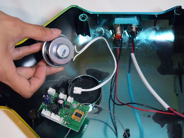

    • within the plug side shell piece, there are two white and pink wires connecting the shell and the motherboard.
    • On the circuit board by the speaker, carefully squeeze and unplug the small white headers that connect the shell piece to the hoverboard body.
    • On the body of the board, follow the wires that connect the lights to the motherboard. Disconnect these wires from the motherboard by squeezing and pulling the small white headers.
    • Now you can fully remove the shell piece.

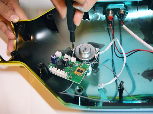

    • Using a Phillips #0 Screwdriver, remove the 3 screws holding the speaker to the shell.
    • Lift the speaker out from the casing.
