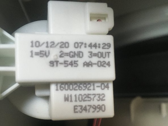

  1. Hotpoint NSWR 963C WK - Accessing Water Level Sensor, Remove lid: crwdns2935265:01crwdnd2935265:01crwdnd2935265:01crwdne2935265:0
    • Remove the two screw the connect back of lid to back of washing machine
    • Lift back of lid vertically hinging at the front
    • At about 45 degree to front of lit should become free and the whole lid can be lifted away.
  2. Hotpoint NSWR 963C WK - Accessing Water Level Sensor, The pressure sensor: crwdns2935265:02crwdnd2935265:01crwdnd2935265:02crwdne2935265:0 Hotpoint NSWR 963C WK - Accessing Water Level Sensor, The pressure sensor: crwdns2935265:02crwdnd2935265:02crwdnd2935265:02crwdne2935265:0
