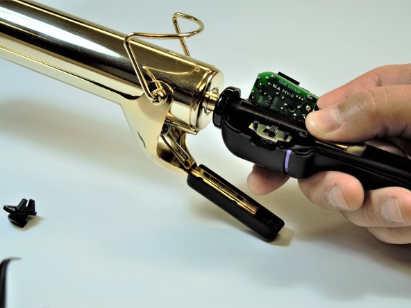

  8. Hot Tools Professional 1110 Power Switch Replacement, Power Switch: crwdns2935265:08crwdnd2935265:01crwdnd2935265:02crwdne2935265:0 Hot Tools Professional 1110 Power Switch Replacement, Power Switch: crwdns2935265:08crwdnd2935265:02crwdnd2935265:02crwdne2935265:0
    • Remove the power switch button exposing the electrically connected power switch.
  9. Hot Tools Professional 1110 Power Switch Replacement: crwdns2935265:09crwdnd2935265:01crwdnd2935265:01crwdne2935265:0
    • Remove power switch from the housing and desolder the three connected electrical wires. Take note of the orientation of each of the electrical wires to ensure that they are replaced correctly.
  10. Hot Tools Professional 1110 Power Switch Replacement: crwdns2935265:010crwdnd2935265:01crwdnd2935265:01crwdne2935265:0
    • Ensuring that the three connecting electrical wires are in the correct orientation, solder the new power switch to the wires.
