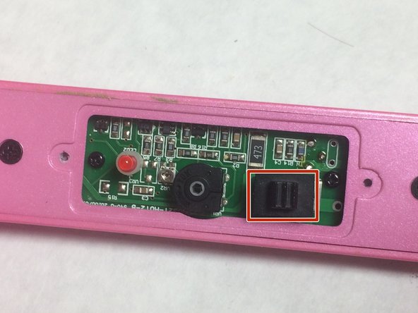

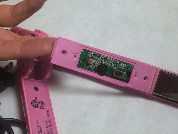

    • Use the JIS #0 screwdriver to remove the two 3.5mm “J0” screws that attach the control assembly cover to the flat iron base.
  5. Hot Tools HPK12 Thermal Fuse Replacement: crwdns2935265:05crwdnd2935265:01crwdnd2935265:03crwdne2935265:0 Hot Tools HPK12 Thermal Fuse Replacement: crwdns2935265:05crwdnd2935265:02crwdnd2935265:03crwdne2935265:0 Hot Tools HPK12 Thermal Fuse Replacement: crwdns2935265:05crwdnd2935265:03crwdnd2935265:03crwdne2935265:0

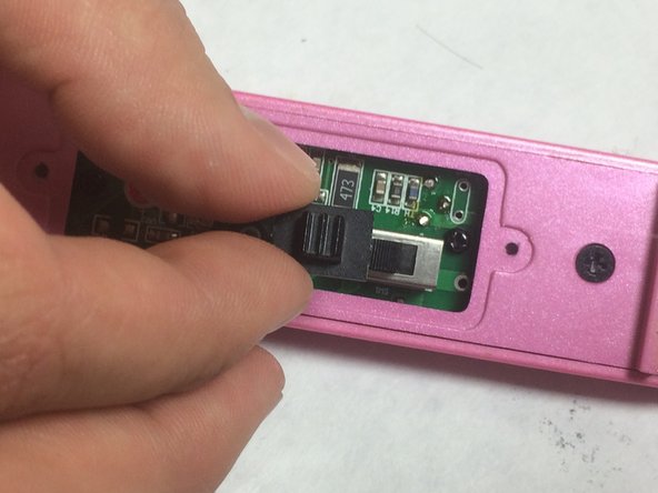

    • Lift upward on the control assembly cover to remove it from the flat iron base.
    • Remove dial and switch cover and set aside.

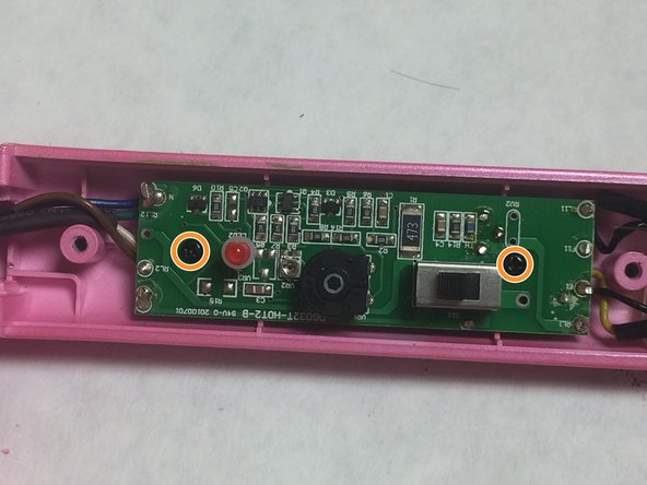

  6. Hot Tools HPK12 Thermal Fuse Replacement: crwdns2935265:06crwdnd2935265:01crwdnd2935265:03crwdne2935265:0 Hot Tools HPK12 Thermal Fuse Replacement: crwdns2935265:06crwdnd2935265:02crwdnd2935265:03crwdne2935265:0 Hot Tools HPK12 Thermal Fuse Replacement: crwdns2935265:06crwdnd2935265:03crwdnd2935265:03crwdne2935265:0
    • Use your JIS #0 screw driver to remove the two 6mm “J0” screws that are attached to the flat iron base and set them aside.
    • Lift the backing plate upwards to remove it from the flat iron.
    • Use the Phillips #0 screwdriver to remove two 4mm “PH0” screws that attach the circuit assembly to the flat iron base.
