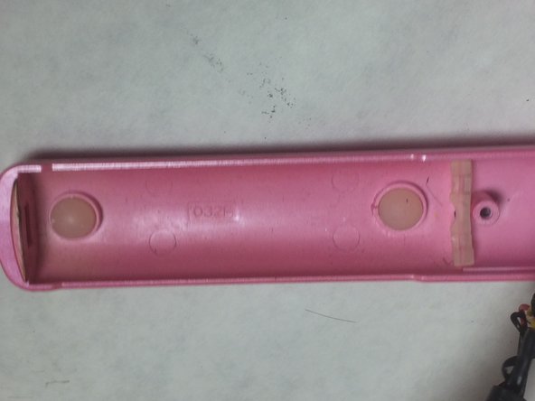

  7. Hot Tools HPK12 Heating Plate Replacement, Heating Plates: crwdns2935265:07crwdnd2935265:01crwdnd2935265:01crwdne2935265:0
    • Lift plate and circuit assembly away from flat iron case.
  8. Hot Tools HPK12 Heating Plate Replacement: crwdns2935265:08crwdnd2935265:01crwdnd2935265:01crwdne2935265:0
    • Flip device to access the non-control assembly flat iron arm and remove two 3.5mm “J0” screws that attaches cover to flat iron base.
  9. Hot Tools HPK12 Heating Plate Replacement: crwdns2935265:09crwdnd2935265:01crwdnd2935265:01crwdne2935265:0
    • Lift cover from flat iron case.
  10. Hot Tools HPK12 Heating Plate Replacement: crwdns2935265:010crwdnd2935265:01crwdnd2935265:02crwdne2935265:0 Hot Tools HPK12 Heating Plate Replacement: crwdns2935265:010crwdnd2935265:02crwdnd2935265:02crwdne2935265:0
    • Lift heating plate away from flat iron case.
