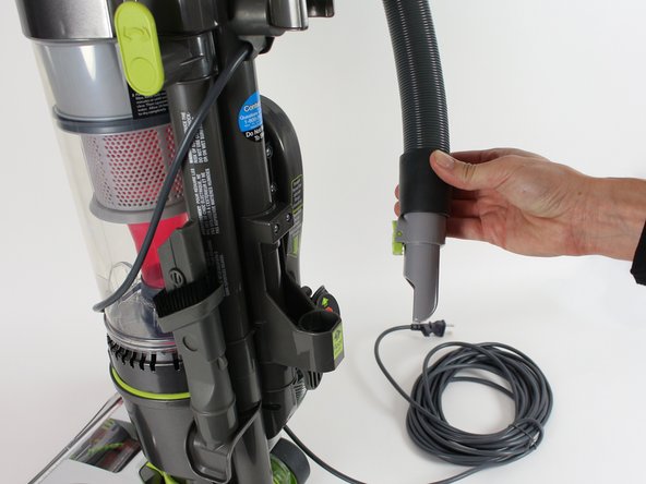

Hoover Windtunnel Air Steerable Upright Suction Hose Replacement
  1. Hoover Windtunnel Air Steerable Upright Suction Hose Replacement, Suction Hose: crwdns2935265:01crwdnd2935265:01crwdnd2935265:01crwdne2935265:0
    • Turn the power off and unplug the power cord.
    • Set the cleaner in the upright position.

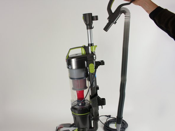

  2. Hoover Windtunnel Air Steerable Upright Suction Hose Replacement: crwdns2935265:02crwdnd2935265:01crwdnd2935265:01crwdne2935265:0
    • Dislodge hose from plastic clips for ease of removal.
  3. Hoover Windtunnel Air Steerable Upright Suction Hose Replacement: crwdns2935265:03crwdnd2935265:01crwdnd2935265:01crwdne2935265:0
    • Press firmly on the hose button and slide hose out.
  4. Hoover Windtunnel Air Steerable Upright Suction Hose Replacement: crwdns2935265:04crwdnd2935265:01crwdnd2935265:03crwdne2935265:0 Hoover Windtunnel Air Steerable Upright Suction Hose Replacement: crwdns2935265:04crwdnd2935265:02crwdnd2935265:03crwdne2935265:0 Hoover Windtunnel Air Steerable Upright Suction Hose Replacement: crwdns2935265:04crwdnd2935265:03crwdnd2935265:03crwdne2935265:0
    • Pull the hose out of the top of the vacuum.
    • The hose is connected to the vacuum handle.
    • The bottom of the hose should come out when the top of the hose is pulled away from the vacuum.
