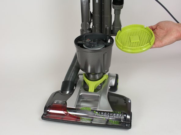

    • Put the cleaner into the upright position, turn the power off, and unplug the power cord.
  2. Hoover Windtunnel Air Steerable Upright Motor Assembly  Replacement: crwdns2935265:02crwdnd2935265:01crwdnd2935265:03crwdne2935265:0 Hoover Windtunnel Air Steerable Upright Motor Assembly  Replacement: crwdns2935265:02crwdnd2935265:02crwdnd2935265:03crwdne2935265:0 Hoover Windtunnel Air Steerable Upright Motor Assembly  Replacement: crwdns2935265:02crwdnd2935265:03crwdnd2935265:03crwdne2935265:0
    • Remove the dirt cup from the cleaner.
    • The HEPA filter is located under the dirt cup and under where it says HEPA.
    • Twist the top counterclockwise to unlock the cap.
  3. Hoover Windtunnel Air Steerable Upright Motor Assembly  Replacement: crwdns2935265:03crwdnd2935265:01crwdnd2935265:02crwdne2935265:0 Hoover Windtunnel Air Steerable Upright Motor Assembly  Replacement: crwdns2935265:03crwdnd2935265:02crwdnd2935265:02crwdne2935265:0
    • Lift the HEPA filter out.
    • Tap the filter against the inside of a trashcan to knock out the dirt and debris or replace as necessary.
    • Do not wash the HEPA Filter.

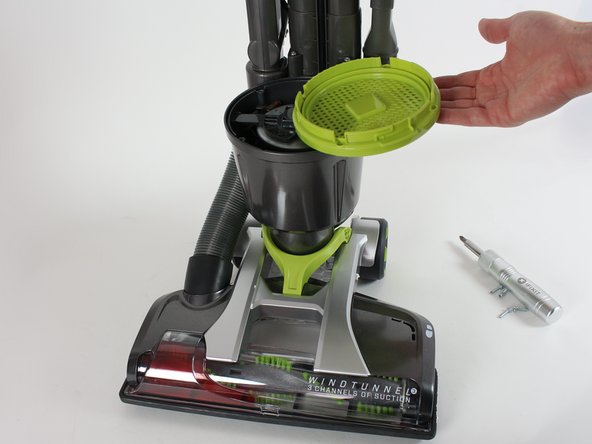

  4. Hoover Windtunnel Air Steerable Upright Motor Assembly  Replacement, Motor Assembly: crwdns2935265:04crwdnd2935265:01crwdnd2935265:03crwdne2935265:0 Hoover Windtunnel Air Steerable Upright Motor Assembly  Replacement, Motor Assembly: crwdns2935265:04crwdnd2935265:02crwdnd2935265:03crwdne2935265:0 Hoover Windtunnel Air Steerable Upright Motor Assembly  Replacement, Motor Assembly: crwdns2935265:04crwdnd2935265:03crwdnd2935265:03crwdne2935265:0
    • Remove the 4 retaining screws and remove the filter tray.
    • Screw lengths are approximately 3/4".

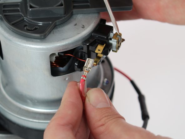

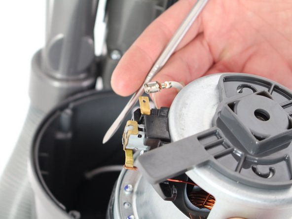

  6. Hoover Windtunnel Air Steerable Upright Motor Assembly  Replacement: crwdns2935265:06crwdnd2935265:01crwdnd2935265:03crwdne2935265:0 Hoover Windtunnel Air Steerable Upright Motor Assembly  Replacement: crwdns2935265:06crwdnd2935265:02crwdnd2935265:03crwdne2935265:0 Hoover Windtunnel Air Steerable Upright Motor Assembly  Replacement: crwdns2935265:06crwdnd2935265:03crwdnd2935265:03crwdne2935265:0
    • Use a plastic spudger or opening tool to press on the small circle and wiggle clips free.
