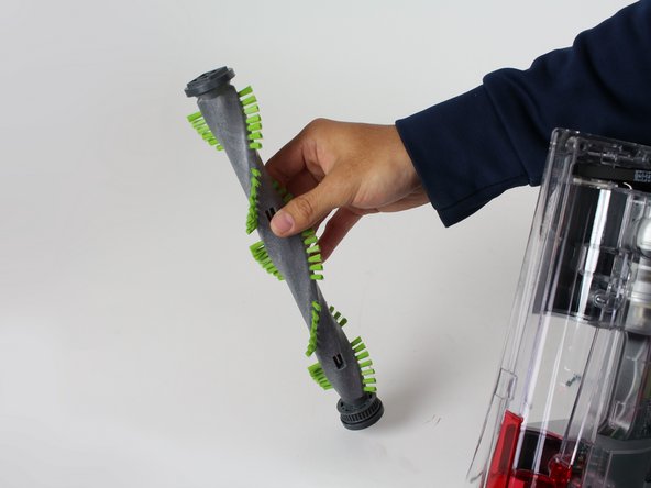

    • Remove the 4 phillips 3/4'' screws that hold the bottom plate.
  2. Hoover Windtunnel Air Steerable Upright Brush Roll Replacement: crwdns2935265:02crwdnd2935265:01crwdnd2935265:02crwdne2935265:0 Hoover Windtunnel Air Steerable Upright Brush Roll Replacement: crwdns2935265:02crwdnd2935265:02crwdnd2935265:02crwdne2935265:0
    • Lift the plate up and off the vacuum head.
  3. Hoover Windtunnel Air Steerable Upright Brush Roll Replacement: crwdns2935265:03crwdnd2935265:01crwdnd2935265:02crwdne2935265:0 Hoover Windtunnel Air Steerable Upright Brush Roll Replacement: crwdns2935265:03crwdnd2935265:02crwdnd2935265:02crwdne2935265:0
    • Pull the brush roll away from the belt and remove the old brush roll.
To reassemble your device, follow these steps in reverse order.

What I find really frustrating is no one sells the felt bushing that holds the brushroll next to the belt.
