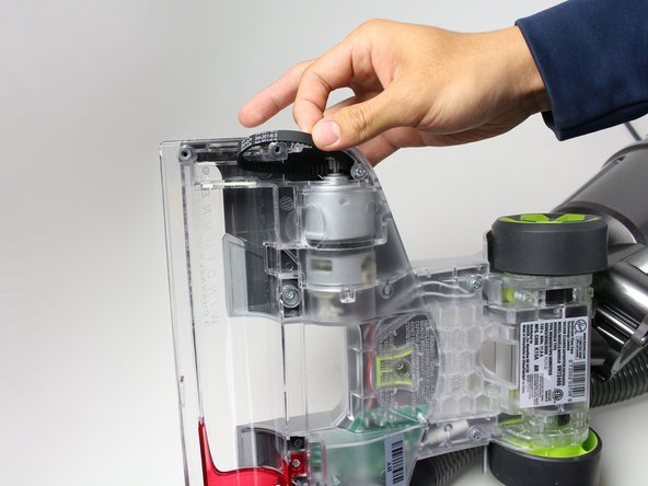

    • Unplug power cord before you begin.
    • Remove the 4 phillips 3/4'' screws.
  2. Hoover Windtunnel Air Steerable Upright Belt Replacement: crwdns2935265:02crwdnd2935265:01crwdnd2935265:02crwdne2935265:0 Hoover Windtunnel Air Steerable Upright Belt Replacement: crwdns2935265:02crwdnd2935265:02crwdnd2935265:02crwdne2935265:0
    • Lift off the plate.
  3. Hoover Windtunnel Air Steerable Upright Belt Replacement: crwdns2935265:03crwdnd2935265:01crwdnd2935265:02crwdne2935265:0 Hoover Windtunnel Air Steerable Upright Belt Replacement: crwdns2935265:03crwdnd2935265:02crwdnd2935265:02crwdne2935265:0
    • Separate the belt from the brush roll.

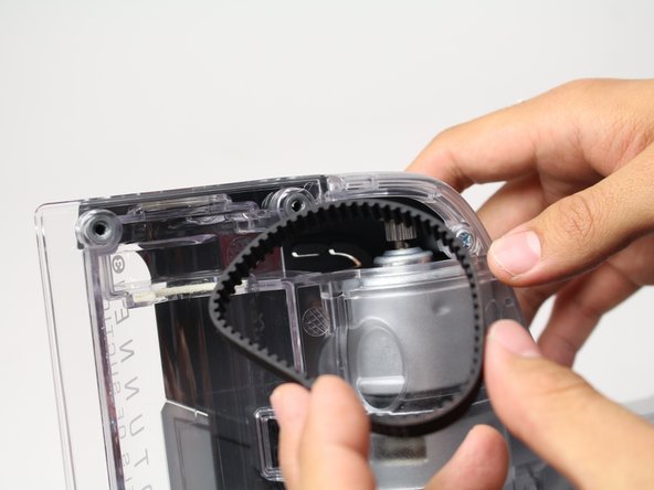

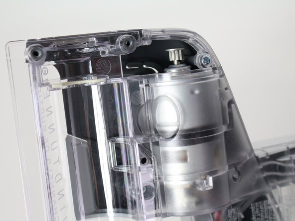

  4. Hoover Windtunnel Air Steerable Upright Belt Replacement: crwdns2935265:04crwdnd2935265:01crwdnd2935265:03crwdne2935265:0 Hoover Windtunnel Air Steerable Upright Belt Replacement: crwdns2935265:04crwdnd2935265:02crwdnd2935265:03crwdne2935265:0 Hoover Windtunnel Air Steerable Upright Belt Replacement: crwdns2935265:04crwdnd2935265:03crwdnd2935265:03crwdne2935265:0
    • Remove the belt from the gear.
To reassemble your device, follow these steps in reverse order.
