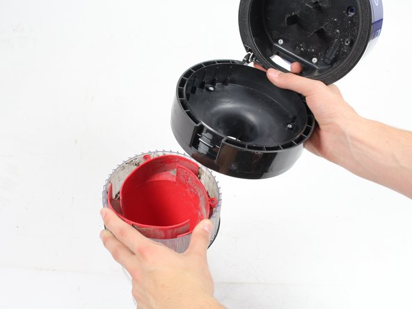

  4. Hoover WindTunnel 2 Rewind Dust Cup Assembly Replacement, Dust Cup Assembly: crwdns2935265:04crwdnd2935265:01crwdnd2935265:01crwdne2935265:0
    • Holding onto both the top handle and dust cup body, twist the two components apart following the instructions printed on the back.
  5. Hoover WindTunnel 2 Rewind Dust Cup Assembly Replacement: crwdns2935265:05crwdnd2935265:01crwdnd2935265:02crwdne2935265:0 Hoover WindTunnel 2 Rewind Dust Cup Assembly Replacement: crwdns2935265:05crwdnd2935265:02crwdnd2935265:02crwdne2935265:0
    • Unscrew the three 4 cm Phillips #3 screws located inside the dust filter compartment to detach the dust filter system.
