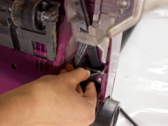

    • Push the red release lever to the right.
    • Turn the red switch counterclockwise.
    • Tilt the bottom of the plastic tray out towards you and pull it off the vacuum.
  2. Hoover T-Series WindTunnel Pet UH70102 Belt Replacement: crwdns2935265:02crwdnd2935265:01crwdnd2935265:01crwdne2935265:0
    • Pull the brush roll out of vacuum.
    • Remove the belt from brush roller

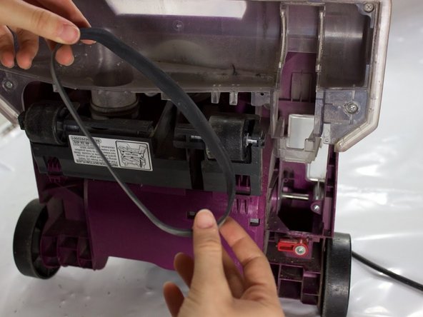

  3. Hoover T-Series WindTunnel Pet UH70102 Belt Replacement, Belt: crwdns2935265:03crwdnd2935265:01crwdnd2935265:03crwdne2935265:0 Hoover T-Series WindTunnel Pet UH70102 Belt Replacement, Belt: crwdns2935265:03crwdnd2935265:02crwdnd2935265:03crwdne2935265:0 Hoover T-Series WindTunnel Pet UH70102 Belt Replacement, Belt: crwdns2935265:03crwdnd2935265:03crwdnd2935265:03crwdne2935265:0
    • Remove the belt that's to the right of where the brush roll was by pulling the bottom off of the pin.
