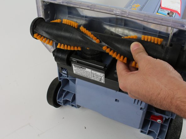

    • Place the vacuum on its back.
    • On the bottom right side, push the red lever to the left.
    • Remove the plastic cover.

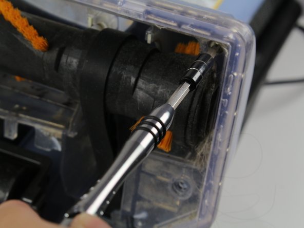

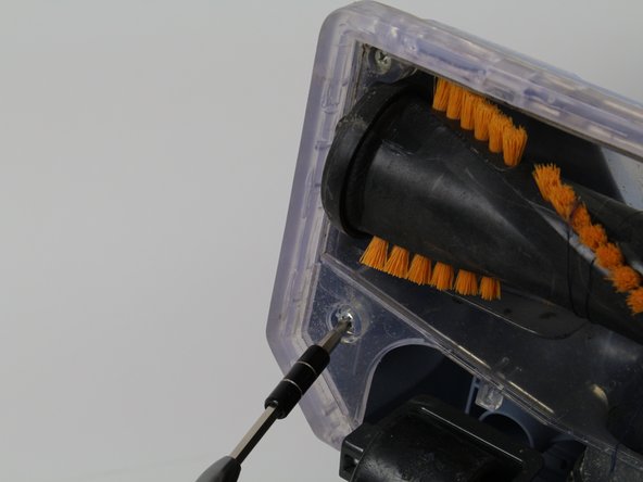

  3. Hoover T-Series WindTunnel Pet UH30310 Vacuum Belt Replacement: crwdns2935265:03crwdnd2935265:01crwdnd2935265:03crwdne2935265:0 Hoover T-Series WindTunnel Pet UH30310 Vacuum Belt Replacement: crwdns2935265:03crwdnd2935265:02crwdnd2935265:03crwdne2935265:0 Hoover T-Series WindTunnel Pet UH30310 Vacuum Belt Replacement: crwdns2935265:03crwdnd2935265:03crwdnd2935265:03crwdne2935265:0
    • Use a Phillips #1 screwdriver to remove the two screws on the right side of the brush.

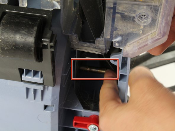

  4. Hoover T-Series WindTunnel Pet UH30310 Vacuum Belt Replacement: crwdns2935265:04crwdnd2935265:01crwdnd2935265:03crwdne2935265:0 Hoover T-Series WindTunnel Pet UH30310 Vacuum Belt Replacement: crwdns2935265:04crwdnd2935265:02crwdnd2935265:03crwdne2935265:0 Hoover T-Series WindTunnel Pet UH30310 Vacuum Belt Replacement: crwdns2935265:04crwdnd2935265:03crwdnd2935265:03crwdne2935265:0
    • Remove the two screws on the left side of the brush.

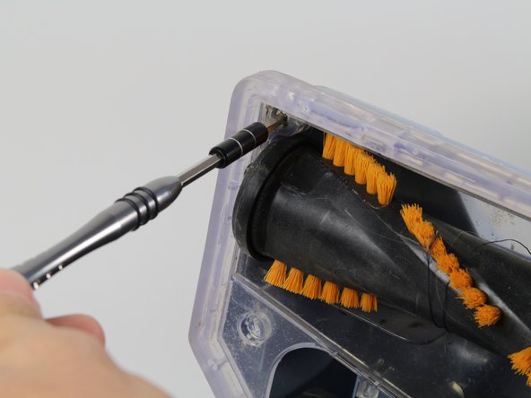

  5. Hoover T-Series WindTunnel Pet UH30310 Vacuum Belt Replacement: crwdns2935265:05crwdnd2935265:01crwdnd2935265:03crwdne2935265:0 Hoover T-Series WindTunnel Pet UH30310 Vacuum Belt Replacement: crwdns2935265:05crwdnd2935265:02crwdnd2935265:03crwdne2935265:0 Hoover T-Series WindTunnel Pet UH30310 Vacuum Belt Replacement: crwdns2935265:05crwdnd2935265:03crwdnd2935265:03crwdne2935265:0
    • Pull the clear plastic away from the head of the vacuum.
    • Slide the belt off the metal rod with your finger.
    • Pull the brush free.

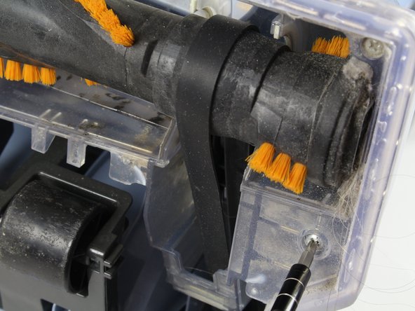

  6. Hoover T-Series WindTunnel Pet UH30310 Vacuum Belt Replacement, Vacuum Belt: crwdns2935265:06crwdnd2935265:01crwdnd2935265:01crwdne2935265:0
    • Removal of the brush will also remove the belt.
