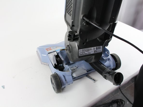

    • Depress the hose-release tab.
  2. Hoover T-Series WindTunnel Pet UH30310 Motor Replacement: crwdns2935265:02crwdnd2935265:01crwdnd2935265:01crwdne2935265:0
    • Next, remove the hose from the connector, near the top of the vacuum's rear. This can be achieved by twisting and then pulling down.

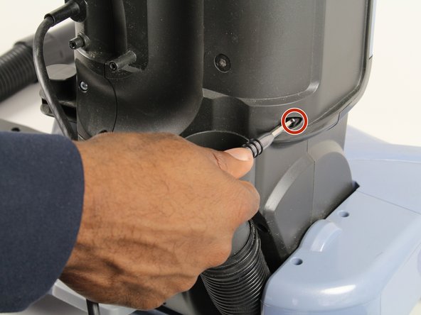

  3. Hoover T-Series WindTunnel Pet UH30310 Motor Replacement: crwdns2935265:03crwdnd2935265:01crwdnd2935265:01crwdne2935265:0
    • Use a Phillips #1 screwdriver to remove the two screws on the part holding the hose to the back of the vacuum.

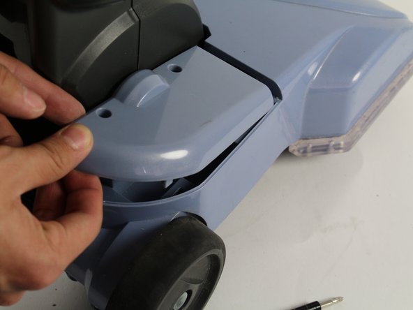

  4. Hoover T-Series WindTunnel Pet UH30310 Motor Replacement: crwdns2935265:04crwdnd2935265:01crwdnd2935265:01crwdne2935265:0
    • Use a Phillips #1 screwdriver to remove the two screws that secure the hose-release tab.

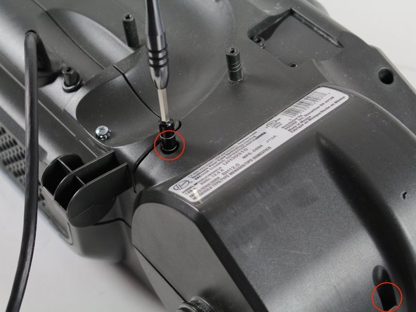

  5. Hoover T-Series WindTunnel Pet UH30310 Motor Replacement: crwdns2935265:05crwdnd2935265:01crwdnd2935265:01crwdne2935265:0
    • Use a Phillips #1 screwdriver to remove the two screws on the top of the vacuum holding the tab on the left of the vacuum.

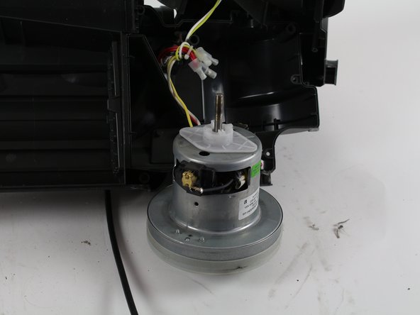

  9. Hoover T-Series WindTunnel Pet UH30310 Motor Replacement: crwdns2935265:09crwdnd2935265:01crwdnd2935265:01crwdne2935265:0
    • The top of the motor casing should then fold open, revealing the motor.
  10. Hoover T-Series WindTunnel Pet UH30310 Motor Replacement: crwdns2935265:010crwdnd2935265:01crwdnd2935265:02crwdne2935265:0 Hoover T-Series WindTunnel Pet UH30310 Motor Replacement: crwdns2935265:010crwdnd2935265:02crwdnd2935265:02crwdne2935265:0
    • The motor can now be accessed for replacement or repair
