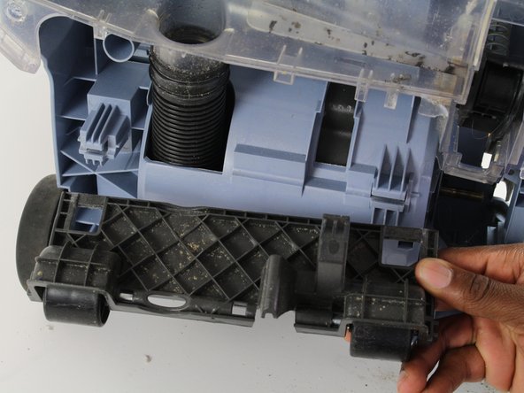

    • Place the vacuum on its back.
    • Push the red switch to the left.
    • The black cover will then pop out. Remove the cover.
  2. Hoover T-Series WindTunnel Pet UH30310 Height Adjustment Wheels Replacement: crwdns2935265:02crwdnd2935265:01crwdnd2935265:03crwdne2935265:0 Hoover T-Series WindTunnel Pet UH30310 Height Adjustment Wheels Replacement: crwdns2935265:02crwdnd2935265:02crwdnd2935265:03crwdne2935265:0 Hoover T-Series WindTunnel Pet UH30310 Height Adjustment Wheels Replacement: crwdns2935265:02crwdnd2935265:03crwdnd2935265:03crwdne2935265:0

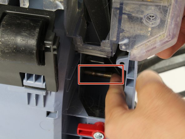

    • Locate the red switch near the head of the vacuum.
    • Push the switch left.
    • This will pop out the plastic base plate. Remove the plate from the vacuum.

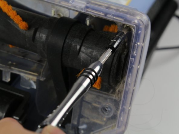

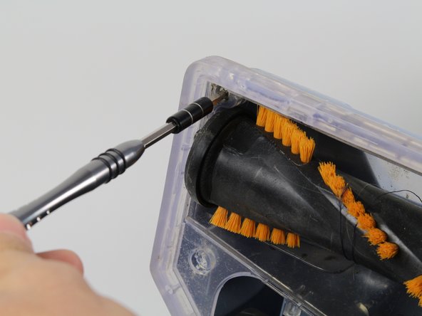

    • Use a Phillips #1 screwdriver to remove the screws from the right side of the white plastic frame.
  4. Hoover T-Series WindTunnel Pet UH30310 Height Adjustment Wheels Replacement: crwdns2935265:04crwdnd2935265:01crwdnd2935265:03crwdne2935265:0 Hoover T-Series WindTunnel Pet UH30310 Height Adjustment Wheels Replacement: crwdns2935265:04crwdnd2935265:02crwdnd2935265:03crwdne2935265:0 Hoover T-Series WindTunnel Pet UH30310 Height Adjustment Wheels Replacement: crwdns2935265:04crwdnd2935265:03crwdnd2935265:03crwdne2935265:0

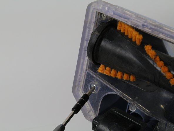

    • Remove screws from the left side of the white plastic frame.

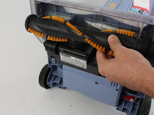

  5. Hoover T-Series WindTunnel Pet UH30310 Height Adjustment Wheels Replacement: crwdns2935265:05crwdnd2935265:01crwdnd2935265:03crwdne2935265:0 Hoover T-Series WindTunnel Pet UH30310 Height Adjustment Wheels Replacement: crwdns2935265:05crwdnd2935265:02crwdnd2935265:03crwdne2935265:0 Hoover T-Series WindTunnel Pet UH30310 Height Adjustment Wheels Replacement: crwdns2935265:05crwdnd2935265:03crwdnd2935265:03crwdne2935265:0

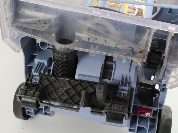

    • Pull the white plastic frame away from the vacuum.
    • Slide the vacuum belt off the metal rod.
    • Pull the brush off the vacuum.

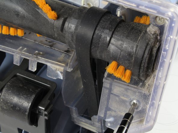

    • Remove the screws at the bottom of the white frame near the roller.

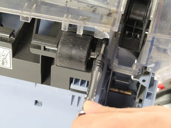

    • Pop off the right side of the white frame.
    • Pull down the blue hinge and roller.
    • Pull free the roller from the vacuum.
