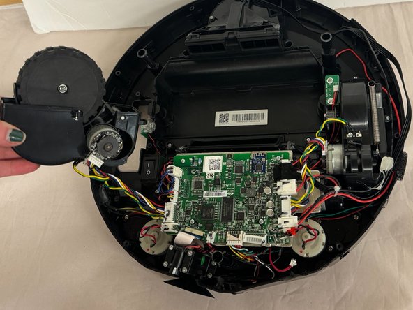

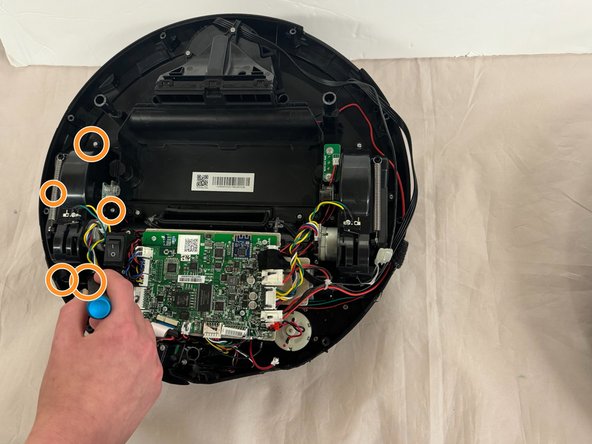

  14. Hoover Rogue 970 Wheel Replacement, Wheel: crwdns2935265:014crwdnd2935265:01crwdnd2935265:02crwdne2935265:0 Hoover Rogue 970 Wheel Replacement, Wheel: crwdns2935265:014crwdnd2935265:02crwdnd2935265:02crwdne2935265:0
    • Locate wheel assembly.
    • Remove the five 8.7 mm screws using a Phillips #0 screwdriver.

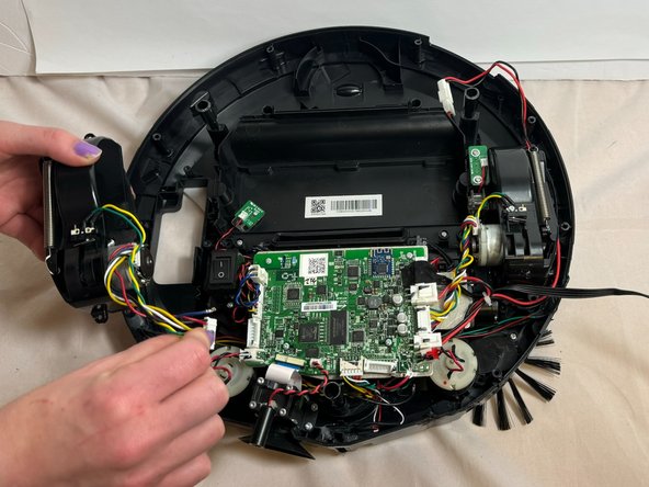

  15. Hoover Rogue 970 Wheel Replacement: crwdns2935265:015crwdnd2935265:01crwdnd2935265:03crwdne2935265:0 Hoover Rogue 970 Wheel Replacement: crwdns2935265:015crwdnd2935265:02crwdnd2935265:03crwdne2935265:0 Hoover Rogue 970 Wheel Replacement: crwdns2935265:015crwdnd2935265:03crwdnd2935265:03crwdne2935265:0
    • Lift the wheel assembly out of the vacuum to access the white bundled cable connector connected to the circuit board.
    • Disconnect the white bundled cable connector that connects the wheel assembly to the circuit board.
    • You may find it helpful to place your other hand's index finger and thumb firmly on the white tab to secure it, avoiding injury or damage to the vacuum.
    • Lift the disconnected wheel assembly away from vacuum.
