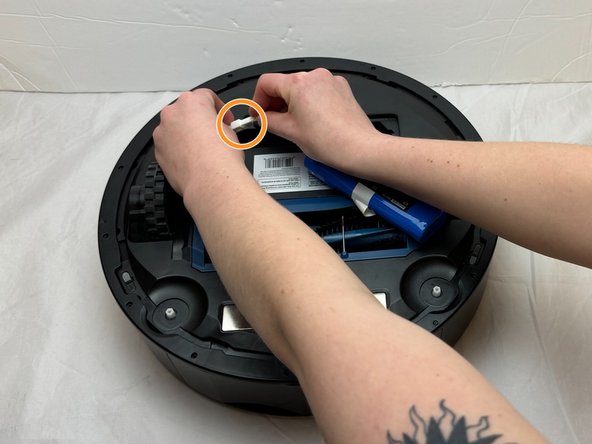

  3. Hoover Rogue 970 Battery Replacement: crwdns2935265:03crwdnd2935265:01crwdnd2935265:03crwdne2935265:0 Hoover Rogue 970 Battery Replacement: crwdns2935265:03crwdnd2935265:02crwdnd2935265:03crwdne2935265:0 Hoover Rogue 970 Battery Replacement: crwdns2935265:03crwdnd2935265:03crwdnd2935265:03crwdne2935265:0
    • If the battery is swollen look here for safety practices.
    • Lift the battery out of the vacuum to access the connected white tab.
    • Disconnect the JST connector that attaches the battery to the vacuum.
