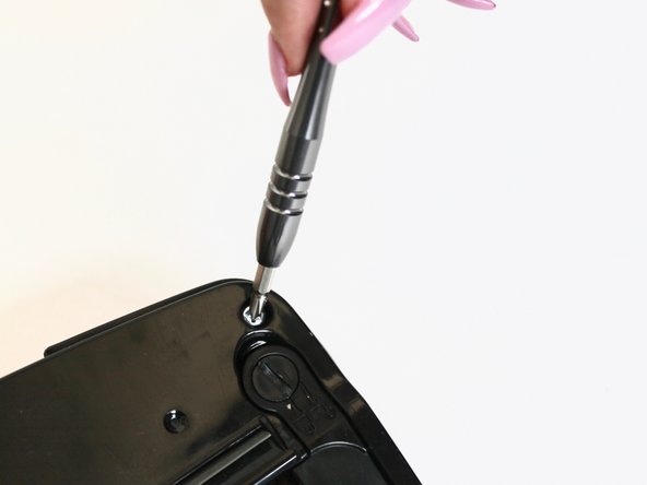

    • Flip the vacuum head over so that the wheels and screws are facing you.
    • Using a PH #1 screw driver, remove the four 15mm screws from each corner of the backside of the vacuum head.

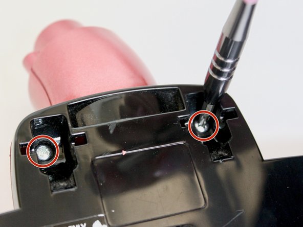

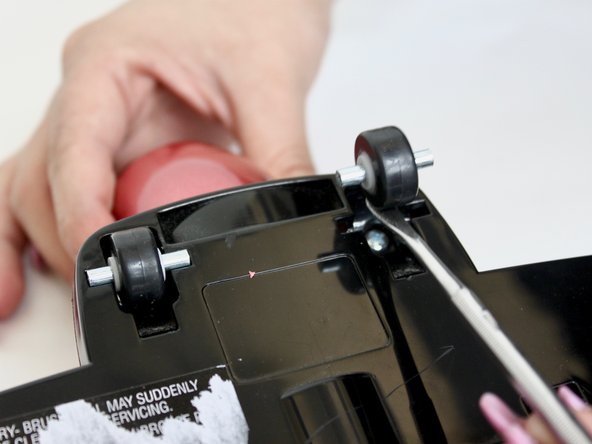

    • Locate the two wheels in the upper half of the vacuum head and remove them by sticking the metal spudger tool underneath the wheel and pushing it towards you until it pops out.
    • Remove the two 15mm screws located under the wheels with a PH #1 screw driver.

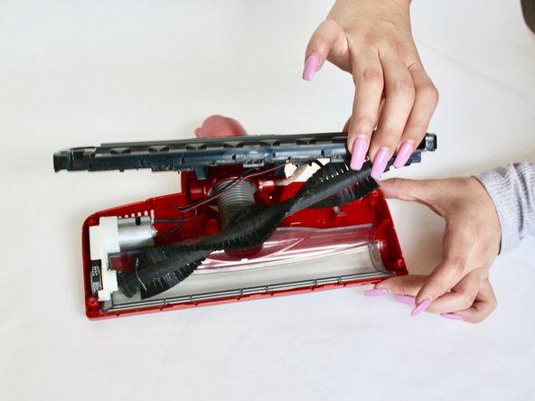

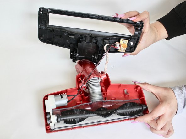

    • Using a firm grip, pull the two halves of the vacuum head away from each other until they are completely separated
  6. Hoover Presto 2-in-1 Cordless Stick Rotating Brush Roll Replacement: crwdns2935265:06crwdnd2935265:01crwdnd2935265:01crwdne2935265:0
    • Remove brush from inside the vacuum head.
