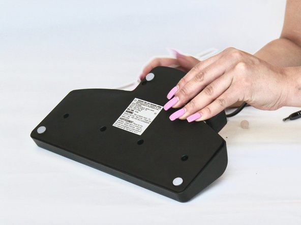

  2. Hoover Presto 2-in-1 Cordless Stick Charger Replacement: crwdns2935265:02crwdnd2935265:01crwdnd2935265:02crwdne2935265:0 Hoover Presto 2-in-1 Cordless Stick Charger Replacement: crwdns2935265:02crwdnd2935265:02crwdnd2935265:02crwdne2935265:0
    • Flip the floor charger over so the screws and sticker are facing you
    • Using a PH #1 screw driver, remove the two 18mm screws on the right hand side of the floor charger

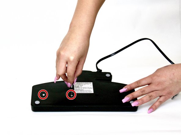

  3. Hoover Presto 2-in-1 Cordless Stick Charger Replacement: crwdns2935265:03crwdnd2935265:01crwdnd2935265:02crwdne2935265:0 Hoover Presto 2-in-1 Cordless Stick Charger Replacement: crwdns2935265:03crwdnd2935265:02crwdnd2935265:02crwdne2935265:0
    • Using a PH #2 screw driver, remove the three 18mm screws on floor charger.

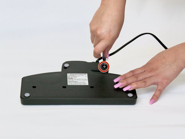

  4. Hoover Presto 2-in-1 Cordless Stick Charger Replacement: crwdns2935265:04crwdnd2935265:01crwdnd2935265:02crwdne2935265:0 Hoover Presto 2-in-1 Cordless Stick Charger Replacement: crwdns2935265:04crwdnd2935265:02crwdnd2935265:02crwdne2935265:0
    • Using the metal spudger tool, gently lift up the plastic cover in the upper right hand corner of the floor attachment to uncover a hidden screw
    • Remove the 18mm screw in the upper right hand corner with a PH #1 screw driver

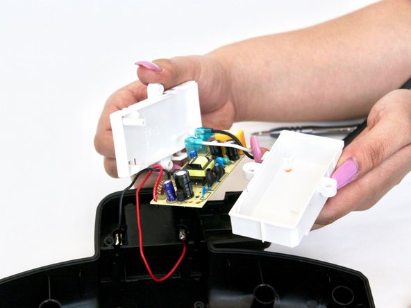

  6. Hoover Presto 2-in-1 Cordless Stick Charger Replacement: crwdns2935265:06crwdnd2935265:01crwdnd2935265:01crwdne2935265:0
    • Unscrew the two 18mm screws on either side of the white battery cover with a PH #1 screw driver
  7. Hoover Presto 2-in-1 Cordless Stick Charger Replacement: crwdns2935265:07crwdnd2935265:01crwdnd2935265:02crwdne2935265:0 Hoover Presto 2-in-1 Cordless Stick Charger Replacement: crwdns2935265:07crwdnd2935265:02crwdnd2935265:02crwdne2935265:0
    • Using your hands, gently pull apart the two halves of the white battery cover to get to the battery

I followed the directions above and got it opened. There was no battery inside. What do I do???? This is for the Hoover Presto 2in1. Thank you.
silvmarg - crwdns2934203:0crwdne2934203:0
Where does one buy the replacement battery?
