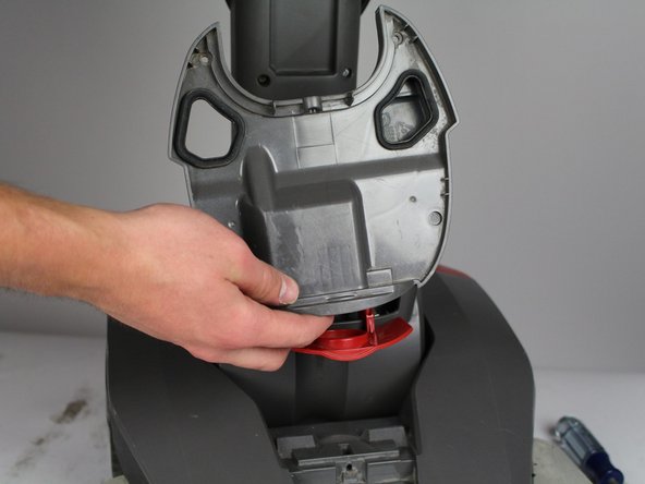

    • Pull the red handle shown to remove the front suction unit from the cleaner.

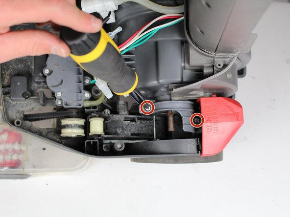

    • Unscrew two screws using Phillips #2 screwdriver.
    • Detach grey piece from vacuum.

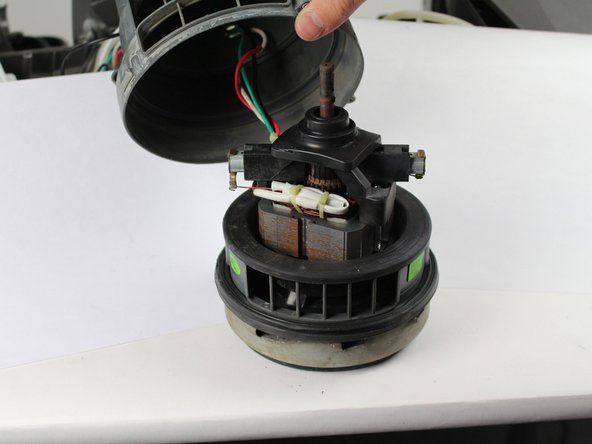

    • Detach motor and unscrew two screws with a Phillips #2 screwdriver.
  15. Hoover Power Path Pro Advanced Suction Motor Replacement: crwdns2935265:015crwdnd2935265:01crwdnd2935265:02crwdne2935265:0 Hoover Power Path Pro Advanced Suction Motor Replacement: crwdns2935265:015crwdnd2935265:02crwdnd2935265:02crwdne2935265:0
    • Pull the bottom section off.
    • Pull the cap off.
