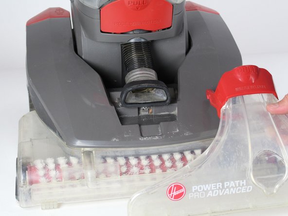

The power switch allows the Hoover Power Path Pro Advanced to turn on with the press of the power button. A defective power switch will not allow the user to control the on and off state of the device and needs to be replaced.
    1. Hoover Power Path Pro Advanced Power Switch Replacement, Power Switch: crwdns2935265:01crwdnd2935265:01crwdnd2935265:01crwdne2935265:0
      • Remove the lower brushroll from the bottom of the cleaner.
    2. Hoover Power Path Pro Advanced Power Switch Replacement: crwdns2935265:02crwdnd2935265:01crwdnd2935265:01crwdne2935265:0

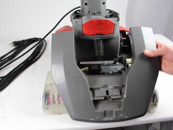

      • Push down on the handle release button. Lift the edge of top cover connected to this button.
      • Repeat the above step for the "On/Off" button.
      • Pull entire top cover off.
      • Caution: when pulling the handle release button, make sure the top of the cleaner does not fall.
    6. Hoover Power Path Pro Advanced Power Switch Replacement: crwdns2935265:06crwdnd2935265:01crwdnd2935265:01crwdne2935265:0
      • Remove the "On/Off" cap by pulling it upwards with caution.
    7. Hoover Power Path Pro Advanced Power Switch Replacement: crwdns2935265:07crwdnd2935265:01crwdnd2935265:01crwdne2935265:0
      • Use a long #2 Philips head to remove the two screws from the arched grey piece.
    8. Hoover Power Path Pro Advanced Power Switch Replacement: crwdns2935265:08crwdnd2935265:01crwdnd2935265:02crwdne2935265:0 Hoover Power Path Pro Advanced Power Switch Replacement: crwdns2935265:08crwdnd2935265:02crwdnd2935265:02crwdne2935265:0
      • Pull out the red power the red power switch.

you have to test the switch, mine tested ok which led me to the fuse between the motor and switch. It was bad, parts warehouse part # 440004065 does the trick.
