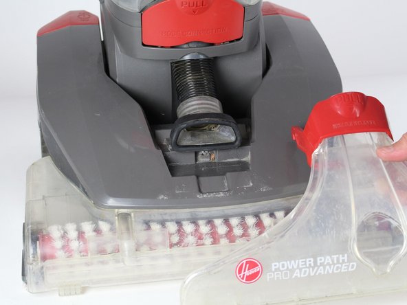

The hose creates a pathway for water to flow from the dirty and clean water tanks on your Hoover Power Path Pro Advanced. However, if there is a puncture in the hose, then it needs to be replaced.
    1. Hoover Power Path Pro Advanced Hose Replacement, Brush Roller: crwdns2935265:01crwdnd2935265:01crwdnd2935265:02crwdne2935265:0 Hoover Power Path Pro Advanced Hose Replacement, Brush Roller: crwdns2935265:01crwdnd2935265:02crwdnd2935265:02crwdne2935265:0
      • Unplug the vacuum cleaner from the wall outlet before starting. Make sure the water tanks are empty.
      • Lay the cleaner down horizontally with its wheels closest to the floor.
    2. Hoover Power Path Pro Advanced Hose Replacement: crwdns2935265:02crwdnd2935265:01crwdnd2935265:02crwdne2935265:0 Hoover Power Path Pro Advanced Hose Replacement: crwdns2935265:02crwdnd2935265:02crwdnd2935265:02crwdne2935265:0
      • Hold the lower brush roll with both hands and pull outwards until it is detached.
    3. Hoover Power Path Pro Advanced Hose Replacement: crwdns2935265:03crwdnd2935265:01crwdnd2935265:01crwdne2935265:0
      • Unscrew the 6 marked screws using a Phillips #2 head screwdriver.
      • Remove the brush roller.
    1. Hoover Power Path Pro Advanced Hose Replacement, Hose: crwdns2935265:04crwdnd2935265:01crwdnd2935265:01crwdne2935265:0
      • Use a long #2 Philips head screwdriver to remove the 8 numbered screws on the bottom of the cleaner.
      • They will also be indicated on the bottom of the vacuum.
    2. Hoover Power Path Pro Advanced Hose Replacement: crwdns2935265:05crwdnd2935265:01crwdnd2935265:02crwdne2935265:0 Hoover Power Path Pro Advanced Hose Replacement: crwdns2935265:05crwdnd2935265:02crwdnd2935265:02crwdne2935265:0
      • Pull the red handle shown to remove the front suction unit from the cleaner.
    3. Hoover Power Path Pro Advanced Hose Replacement: crwdns2935265:06crwdnd2935265:01crwdnd2935265:01crwdne2935265:0
      • Unscrew the Phillips #2 screw at the bottom of the hose.
    4. Hoover Power Path Pro Advanced Hose Replacement: crwdns2935265:07crwdnd2935265:01crwdnd2935265:01crwdne2935265:0
      • Grab the attachment at tip of the hose and unscrew it. Pull outwards on the hose until completely removed.
