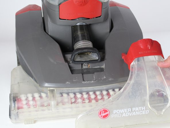

  4. Hoover Power Path Pro Advanced Belt Replacement, Belt: crwdns2935265:04crwdnd2935265:01crwdnd2935265:01crwdne2935265:0
    • Use a long #2 Philips head screwdriver to remove the 8 numbered screws on the bottom of the cleaner.
  5. Hoover Power Path Pro Advanced Belt Replacement: crwdns2935265:05crwdnd2935265:01crwdnd2935265:02crwdne2935265:0 Hoover Power Path Pro Advanced Belt Replacement: crwdns2935265:05crwdnd2935265:02crwdnd2935265:02crwdne2935265:0
    • Pull the red handle shown to remove the front suction unit from the cleaner.
  6. Hoover Power Path Pro Advanced Belt Replacement: crwdns2935265:06crwdnd2935265:01crwdnd2935265:01crwdne2935265:0
    • Unscrew the Phillips #2 screw at the bottom of the hose.

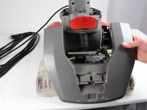

  7. Hoover Power Path Pro Advanced Belt Replacement: crwdns2935265:07crwdnd2935265:01crwdnd2935265:02crwdne2935265:0 Hoover Power Path Pro Advanced Belt Replacement: crwdns2935265:07crwdnd2935265:02crwdnd2935265:02crwdne2935265:0
    • Push down on the handle release button. Pull and disconnect the edge of the top cover on the side of the handle release button.
    • Repeat the above step for the "On/Off" button.
    • When pulling the handle release button, make sure the top of the cleaner does not fall.
  8. Hoover Power Path Pro Advanced Belt Replacement: crwdns2935265:08crwdnd2935265:01crwdnd2935265:01crwdne2935265:0
    • Gently grab the belt and pry it off from the rollers.

Who the heck made this so hard,
Roy Merlino - crwdns2934203:0crwdne2934203:0
Day 5 and 4 people, I still can’t lift the top off to be able to replace belts. Is there a video
Just understand there are more screws to remove then what is described in these 8 steps. Once you removed ALL the screws then the plastic lid comes right off.
Neil Sullivan - crwdns2934203:0crwdne2934203:0
How the back do you put the too belts on and seeing how the bag came with two and both were wide what size is the one that goes around the roller the other one control the circle brushes this is one of the most difficult belt change I've bad and I'm counting on car to
Loretta Staley - crwdns2934203:0crwdne2934203:0
There is only 8 screws you need to remove. The diagram makes it hard to know but there are two top ones Directly under the brush ! Once you get them out then comes off no problem at all.
