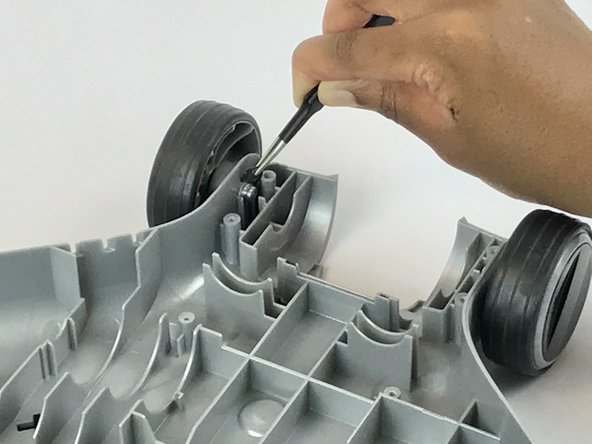

    • Detach the rolling assembly from the body by pushing the button found at the base.
  2. Hoover LiNX Wheel Replacement: crwdns2935265:02crwdnd2935265:01crwdnd2935265:01crwdne2935265:0
    • Remove the seven 7.5mm Phillips #1 screws from the brush retainer.
  3. Hoover LiNX Wheel Replacement: crwdns2935265:03crwdnd2935265:01crwdnd2935265:02crwdne2935265:0 Hoover LiNX Wheel Replacement: crwdns2935265:03crwdnd2935265:02crwdnd2935265:02crwdne2935265:0
    • Remove the brush and retainer from the rolling assembly.
    • The brush will need to be disconnected from the belt.
  4. Hoover LiNX Wheel Replacement: crwdns2935265:04crwdnd2935265:01crwdnd2935265:01crwdne2935265:0
    • Remove the eight 4mm Phillips #1 screws from the bottom panel.
  5. Hoover LiNX Wheel Replacement: crwdns2935265:05crwdnd2935265:01crwdnd2935265:01crwdne2935265:0
    • Remove the bottom panel.
  6. Hoover LiNX Wheel Replacement: crwdns2935265:06crwdnd2935265:01crwdnd2935265:01crwdne2935265:0
    • Remove the motor.
  7. Hoover LiNX Wheel Replacement, Wheel: crwdns2935265:07crwdnd2935265:01crwdnd2935265:02crwdne2935265:0 Hoover LiNX Wheel Replacement, Wheel: crwdns2935265:07crwdnd2935265:02crwdnd2935265:02crwdne2935265:0
    • Remove the black plastic clamp from inside the wheel axle.
  8. Hoover LiNX Wheel Replacement: crwdns2935265:08crwdnd2935265:01crwdnd2935265:03crwdne2935265:0 Hoover LiNX Wheel Replacement: crwdns2935265:08crwdnd2935265:02crwdnd2935265:03crwdne2935265:0 Hoover LiNX Wheel Replacement: crwdns2935265:08crwdnd2935265:03crwdnd2935265:03crwdne2935265:0
    • Remove broken wheel and replace.
