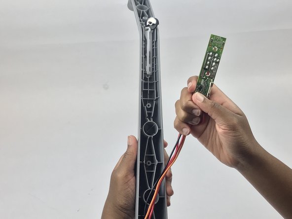

  9. Hoover LiNX Power Button Replacement: crwdns2935265:09crwdnd2935265:01crwdnd2935265:02crwdne2935265:0 Hoover LiNX Power Button Replacement: crwdns2935265:09crwdnd2935265:02crwdnd2935265:02crwdne2935265:0
    • Carefully pull the motherboard out with its attached wires.

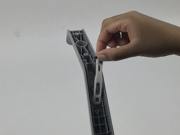

  10. Hoover LiNX Power Button Replacement, Power Button: crwdns2935265:010crwdnd2935265:01crwdnd2935265:02crwdne2935265:0 Hoover LiNX Power Button Replacement, Power Button: crwdns2935265:010crwdnd2935265:02crwdnd2935265:02crwdne2935265:0
    • Replace the power button.
