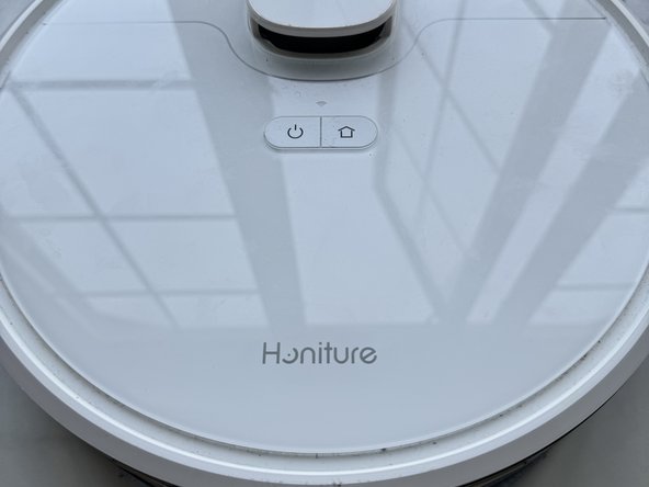

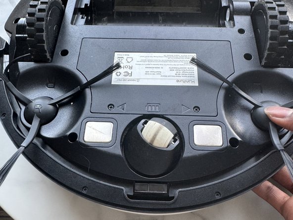

    • Ensure the vacuum is powered off and disconnected from any charging base.
    • Locate the brush compartment on the underside of the vacuum.

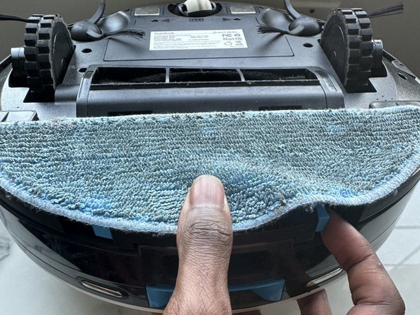

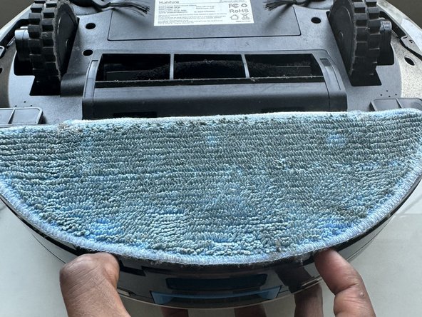

  2. Honiture Q6 SE Robot Vacuum Brushes Replacement: crwdns2935265:02crwdnd2935265:01crwdnd2935265:03crwdne2935265:0 Honiture Q6 SE Robot Vacuum Brushes Replacement: crwdns2935265:02crwdnd2935265:02crwdnd2935265:03crwdne2935265:0 Honiture Q6 SE Robot Vacuum Brushes Replacement: crwdns2935265:02crwdnd2935265:03crwdnd2935265:03crwdne2935265:0

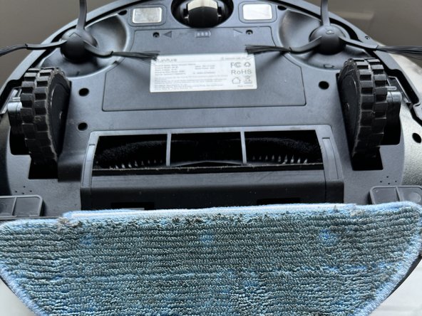

    • Press the blue buttons underneath the rag and pull out the rag to access the brush compartment.

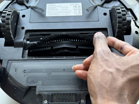

  3. Honiture Q6 SE Robot Vacuum Brushes Replacement: crwdns2935265:03crwdnd2935265:01crwdnd2935265:02crwdne2935265:0 Honiture Q6 SE Robot Vacuum Brushes Replacement: crwdns2935265:03crwdnd2935265:02crwdnd2935265:02crwdne2935265:0

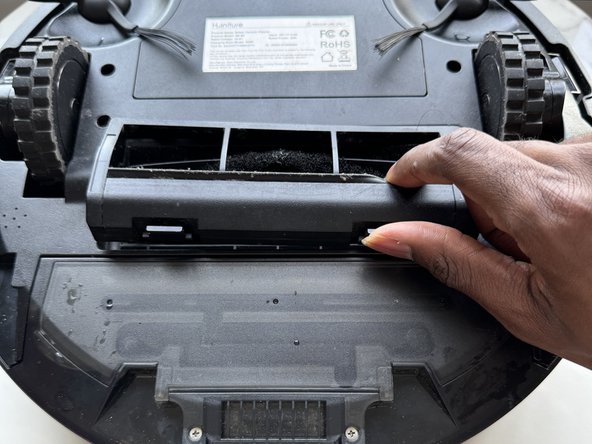

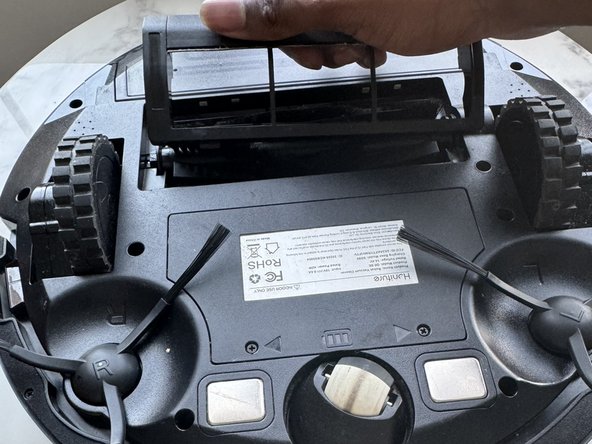

    • Pull out the clip to open the brush compartment.

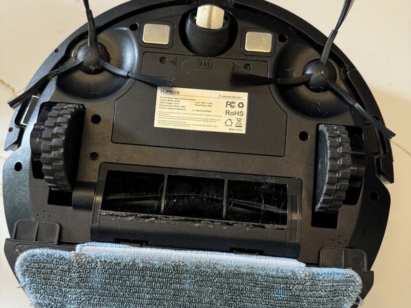

  4. Honiture Q6 SE Robot Vacuum Brushes Replacement: crwdns2935265:04crwdnd2935265:01crwdnd2935265:02crwdne2935265:0 Honiture Q6 SE Robot Vacuum Brushes Replacement: crwdns2935265:04crwdnd2935265:02crwdnd2935265:02crwdne2935265:0
    • Carefully remove the old roller brush from its holder.

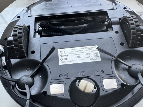

  5. Honiture Q6 SE Robot Vacuum Brushes Replacement: crwdns2935265:05crwdnd2935265:01crwdnd2935265:03crwdne2935265:0 Honiture Q6 SE Robot Vacuum Brushes Replacement: crwdns2935265:05crwdnd2935265:02crwdnd2935265:03crwdne2935265:0 Honiture Q6 SE Robot Vacuum Brushes Replacement: crwdns2935265:05crwdnd2935265:03crwdnd2935265:03crwdne2935265:0

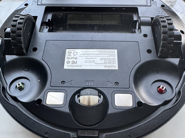

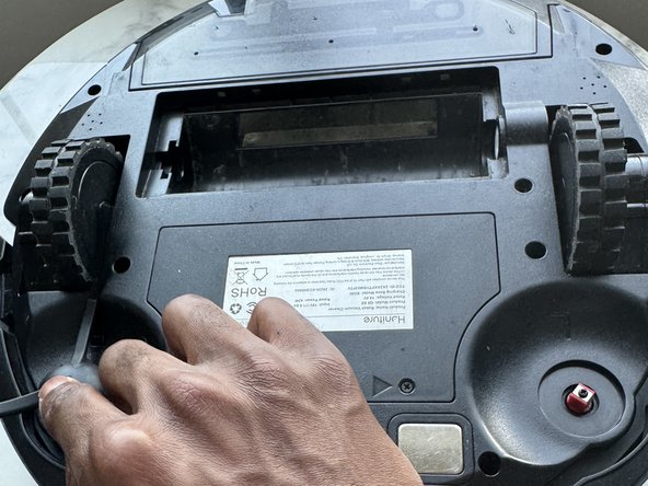

    • Carefully remove the old side brushes from their holders.

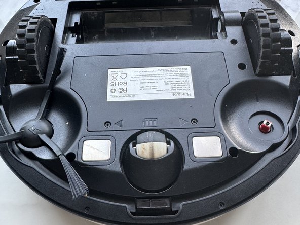

  6. Honiture Q6 SE Robot Vacuum Brushes Replacement: crwdns2935265:06crwdnd2935265:01crwdnd2935265:03crwdne2935265:0 Honiture Q6 SE Robot Vacuum Brushes Replacement: crwdns2935265:06crwdnd2935265:02crwdnd2935265:03crwdne2935265:0 Honiture Q6 SE Robot Vacuum Brushes Replacement: crwdns2935265:06crwdnd2935265:03crwdnd2935265:03crwdne2935265:0
    • Insert the new right-side brush.
    • Insert the new left-side brush.
  7. Honiture Q6 SE Robot Vacuum Brushes Replacement: crwdns2935265:07crwdnd2935265:01crwdnd2935265:03crwdne2935265:0 Honiture Q6 SE Robot Vacuum Brushes Replacement: crwdns2935265:07crwdnd2935265:02crwdnd2935265:03crwdne2935265:0 Honiture Q6 SE Robot Vacuum Brushes Replacement: crwdns2935265:07crwdnd2935265:03crwdnd2935265:03crwdne2935265:0
    • Insert the new roller-brush.
    • Close the roller-brush compartment.
  8. Honiture Q6 SE Robot Vacuum Brushes Replacement: crwdns2935265:08crwdnd2935265:01crwdnd2935265:03crwdne2935265:0 Honiture Q6 SE Robot Vacuum Brushes Replacement: crwdns2935265:08crwdnd2935265:02crwdnd2935265:03crwdne2935265:0 Honiture Q6 SE Robot Vacuum Brushes Replacement: crwdns2935265:08crwdnd2935265:03crwdnd2935265:03crwdne2935265:0

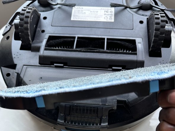

    • Slide the rag back into its holder.
