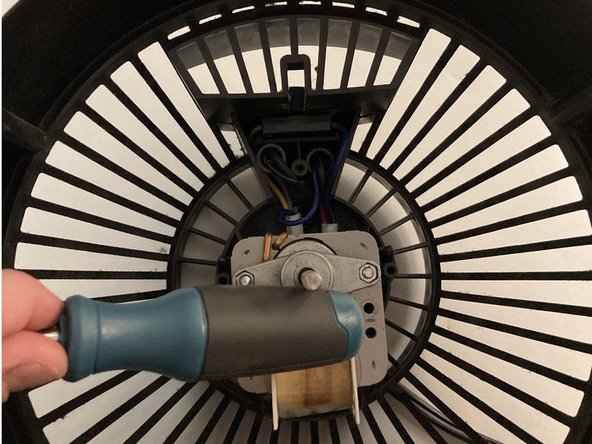

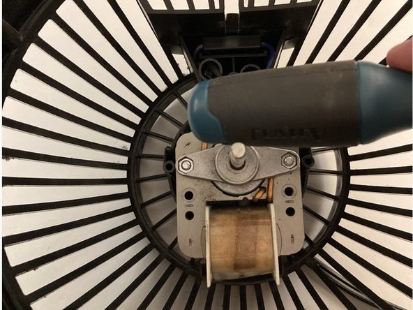

  8. Honeywell Turbo Force Air Circulator Fan Disassembly, Unscrewing the motor: crwdns2935265:08crwdnd2935265:01crwdnd2935265:03crwdne2935265:0 Honeywell Turbo Force Air Circulator Fan Disassembly, Unscrewing the motor: crwdns2935265:08crwdnd2935265:02crwdnd2935265:03crwdne2935265:0 Honeywell Turbo Force Air Circulator Fan Disassembly, Unscrewing the motor: crwdns2935265:08crwdnd2935265:03crwdnd2935265:03crwdne2935265:0
    • Remove the 2 screws on the motor.
    • This allows the motor to pull away from the housing.
  9. Honeywell Turbo Force Air Circulator Fan Disassembly, Pulling the Motor from the Housing: crwdns2935265:09crwdnd2935265:01crwdnd2935265:01crwdne2935265:0
    • Pull the motor away from the housing to expose wiring.
    • Use caution to not detach the wiring from the back.

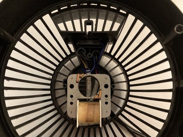

  10. Honeywell Turbo Force Air Circulator Fan Disassembly, Unscrewing the Rotor: crwdns2935265:010crwdnd2935265:01crwdnd2935265:02crwdne2935265:0 Honeywell Turbo Force Air Circulator Fan Disassembly, Unscrewing the Rotor: crwdns2935265:010crwdnd2935265:02crwdnd2935265:02crwdne2935265:0
    • Remove the two screws from the back of the motor.
    • Allows the rotor and front/back bearings to be removed.
  11. Honeywell Turbo Force Air Circulator Fan Disassembly, Removing the Rotor: crwdns2935265:011crwdnd2935265:01crwdnd2935265:02crwdne2935265:0 Honeywell Turbo Force Air Circulator Fan Disassembly, Removing the Rotor: crwdns2935265:011crwdnd2935265:02crwdnd2935265:02crwdne2935265:0
    • Remove the rotor and front bearings by pulling.
