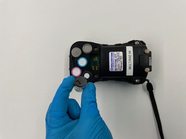

  6. Honeywell MultiRae Hydrogen Sulfide Electrochemical Sensors Replacement: crwdns2935265:06crwdnd2935265:01crwdnd2935265:01crwdne2935265:0
    • Carefully grip and twist the outer edge of the sensor to remove the sensor from its insertion point.
    • Be careful not to twist too aggressively as this could damage the sensor attachment point in the monitor.
  7. Honeywell MultiRae Hydrogen Sulfide Electrochemical Sensors Replacement: crwdns2935265:07crwdnd2935265:01crwdnd2935265:03crwdne2935265:0 Honeywell MultiRae Hydrogen Sulfide Electrochemical Sensors Replacement: crwdns2935265:07crwdnd2935265:02crwdnd2935265:03crwdne2935265:0 Honeywell MultiRae Hydrogen Sulfide Electrochemical Sensors Replacement: crwdns2935265:07crwdnd2935265:03crwdnd2935265:03crwdne2935265:0

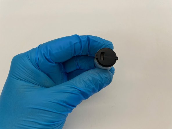

    • Grip the replacement sensor on the outer edge.
    • Insert the new sensor in a straight downward orientation.
    • Be careful to line up the prongs with their insertion/attachment point in the monitor.
