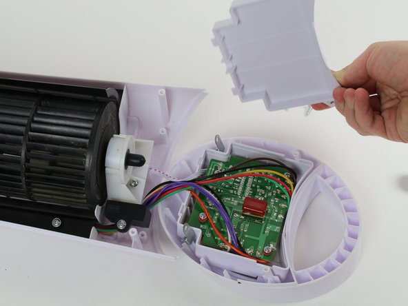

  6. Honeywell HY-254-TGT Front Panel Replacement: crwdns2935265:06crwdnd2935265:01crwdnd2935265:02crwdne2935265:0 Honeywell HY-254-TGT Front Panel Replacement: crwdns2935265:06crwdnd2935265:02crwdnd2935265:02crwdne2935265:0
    • Gently lift and remove the panel covering the electronics assembly.
  7. Honeywell HY-254-TGT Front Panel Replacement: crwdns2935265:07crwdnd2935265:01crwdnd2935265:03crwdne2935265:0 Honeywell HY-254-TGT Front Panel Replacement: crwdns2935265:07crwdnd2935265:02crwdnd2935265:03crwdne2935265:0 Honeywell HY-254-TGT Front Panel Replacement: crwdns2935265:07crwdnd2935265:03crwdnd2935265:03crwdne2935265:0
    • Remove the four 1/2" Phillips #01 screws in the circuit board.
    • Gently pull the circuit board off of the rest of the front panel assembly.
