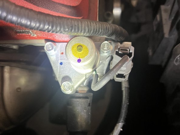

    • Open the hood and locate the VTEC on the front left side of the engine, near the valve cover.
    • Clean the surrounding area to keep dirt out of the engine during removal.

    • Locate and remove the three 10 mm bolts securing the upper solenoid.
    • Keep the bolts organized and be careful not to drop the wire attached by one of them.

    • Place the new upper solenoid onto the housing and align it with the bolt holes.
