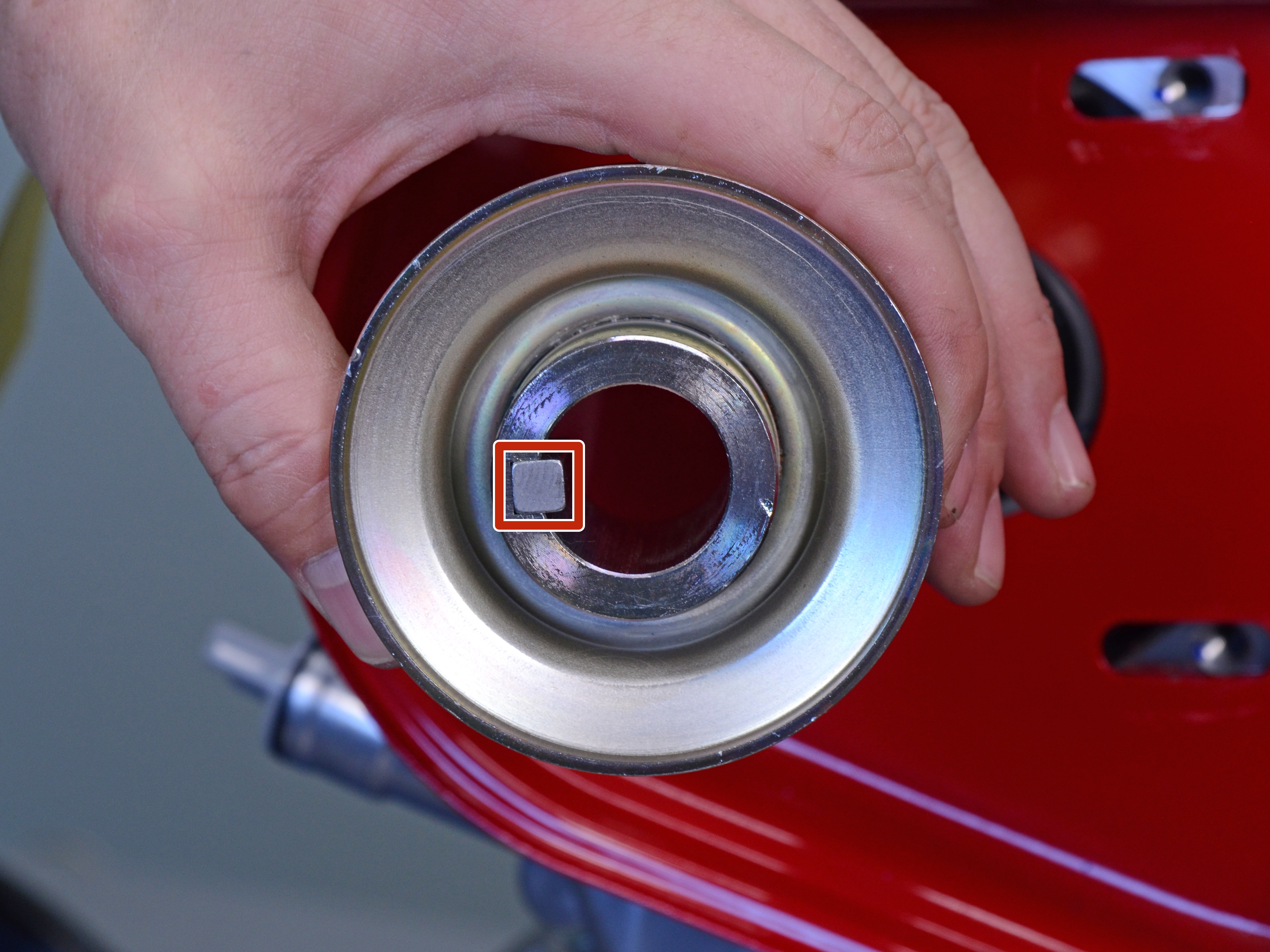

  13. Honda Rear Tine Tiller FRC800K1A P.T.O. Change Fork Replacement, Remove the motor pulley: crwdns2935265:013crwdnd2935265:01crwdnd2935265:02crwdne2935265:0 Honda Rear Tine Tiller FRC800K1A P.T.O. Change Fork Replacement, Remove the motor pulley: crwdns2935265:013crwdnd2935265:02crwdnd2935265:02crwdne2935265:0
    • Remove the motor pulley.
    • Keep track of the key—which may fall out on its own—and keep it with the motor pulley.

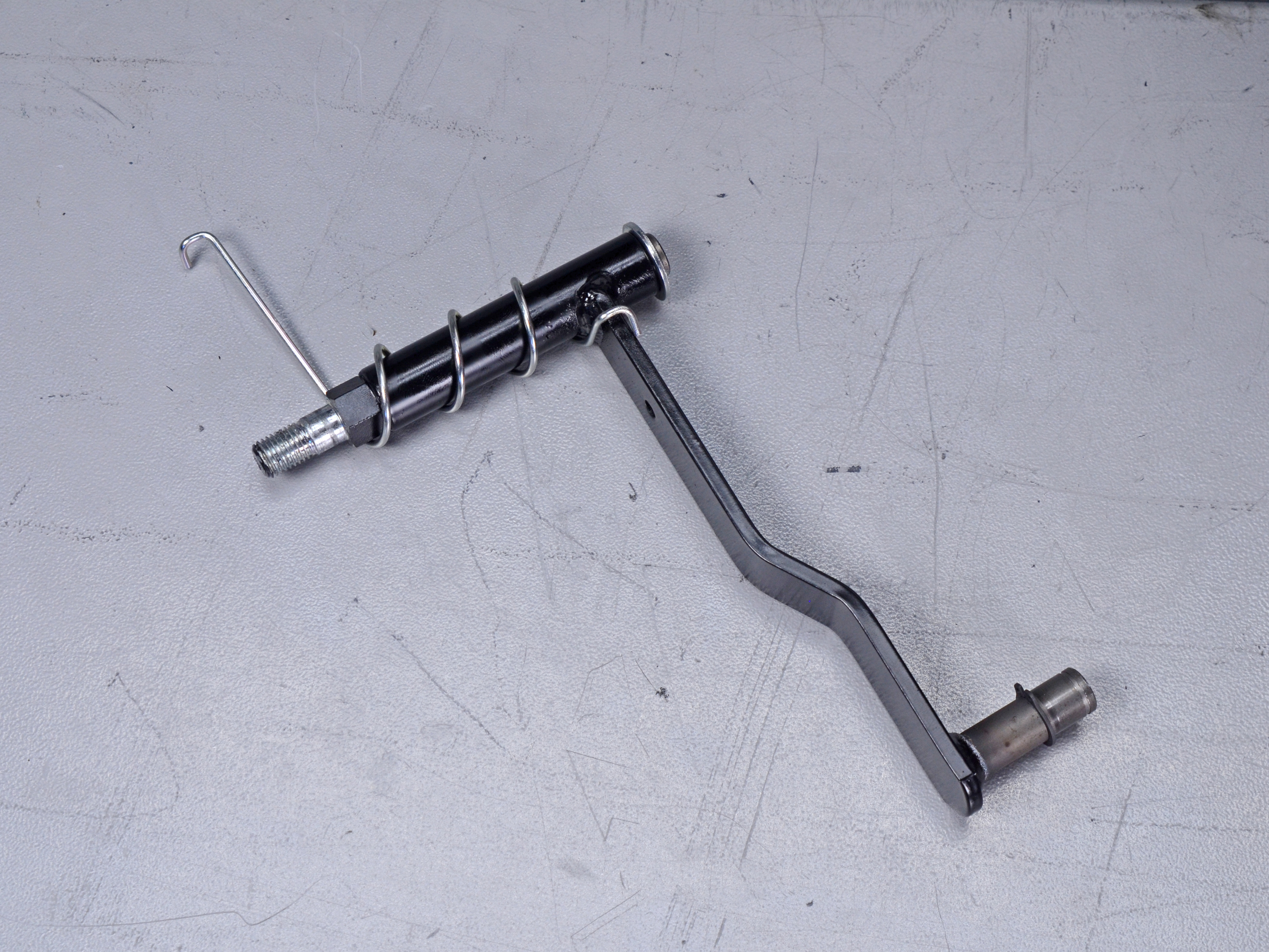

  34. Honda Rear Tine Tiller FRC800K1A P.T.O. Change Fork Replacement, Remove change lever extension: crwdns2935265:034crwdnd2935265:01crwdnd2935265:03crwdne2935265:0 Honda Rear Tine Tiller FRC800K1A P.T.O. Change Fork Replacement, Remove change lever extension: crwdns2935265:034crwdnd2935265:02crwdnd2935265:03crwdne2935265:0 Honda Rear Tine Tiller FRC800K1A P.T.O. Change Fork Replacement, Remove change lever extension: crwdns2935265:034crwdnd2935265:03crwdnd2935265:03crwdne2935265:0
    • Use needle nose pliers to straighten the change lever pin.
    • Pull the pin straight out to remove.
  35. Honda Rear Tine Tiller FRC800K1A P.T.O. Change Fork Replacement: crwdns2935265:035crwdnd2935265:01crwdnd2935265:02crwdne2935265:0 Honda Rear Tine Tiller FRC800K1A P.T.O. Change Fork Replacement: crwdns2935265:035crwdnd2935265:02crwdnd2935265:02crwdne2935265:0
    • Slide the change lever extension off its base to remove.

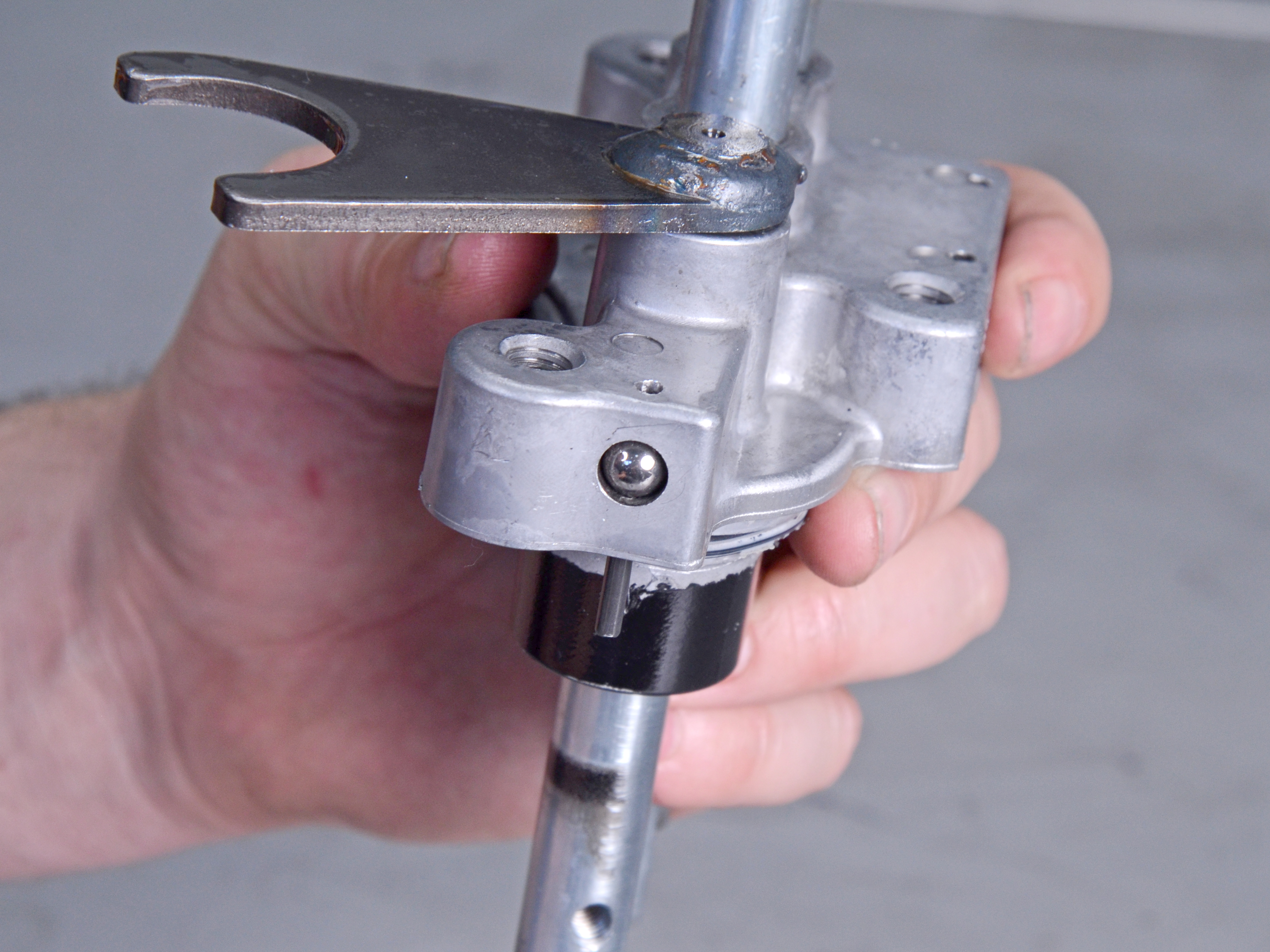

  41. Honda Rear Tine Tiller FRC800K1A P.T.O. Change Fork Replacement, Remove the shifting arms: crwdns2935265:041crwdnd2935265:01crwdnd2935265:03crwdne2935265:0 Honda Rear Tine Tiller FRC800K1A P.T.O. Change Fork Replacement, Remove the shifting arms: crwdns2935265:041crwdnd2935265:02crwdnd2935265:03crwdne2935265:0 Honda Rear Tine Tiller FRC800K1A P.T.O. Change Fork Replacement, Remove the shifting arms: crwdns2935265:041crwdnd2935265:03crwdnd2935265:03crwdne2935265:0
    • Use a 10 mm socket to remove the rotary change shifting arm bolt.
    • Remove the rotary change shifting arm.
  42. Honda Rear Tine Tiller FRC800K1A P.T.O. Change Fork Replacement: crwdns2935265:042crwdnd2935265:01crwdnd2935265:03crwdne2935265:0 Honda Rear Tine Tiller FRC800K1A P.T.O. Change Fork Replacement: crwdns2935265:042crwdnd2935265:02crwdnd2935265:03crwdne2935265:0 Honda Rear Tine Tiller FRC800K1A P.T.O. Change Fork Replacement: crwdns2935265:042crwdnd2935265:03crwdnd2935265:03crwdne2935265:0
    • Use a 10 mm socket to remove the two remaining shifting arm bolts.
    • Remove the two remaining shifting arms.

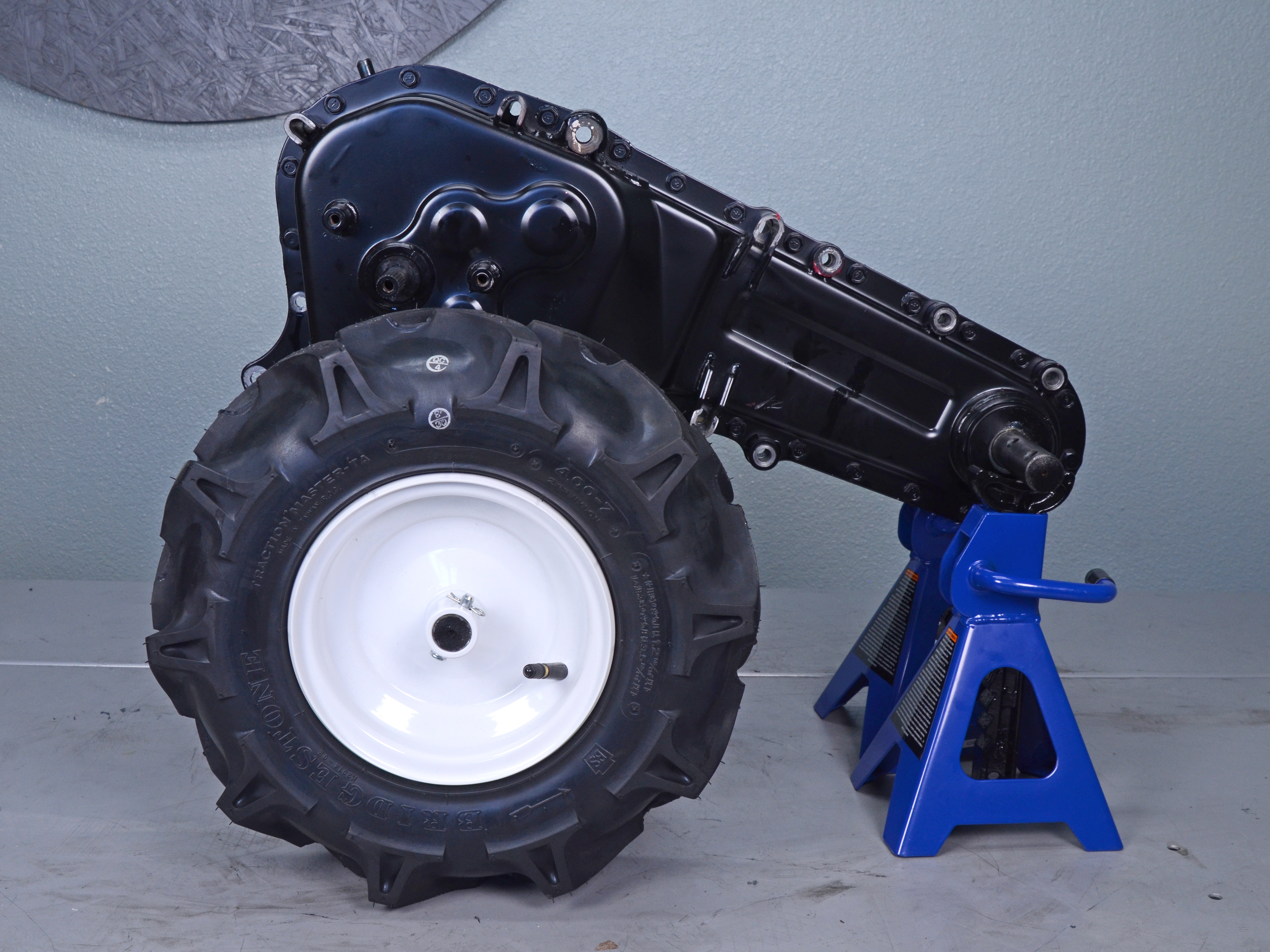

  48. Honda Rear Tine Tiller FRC800K1A P.T.O. Change Fork Replacement: crwdns2935265:048crwdnd2935265:01crwdnd2935265:02crwdne2935265:0 Honda Rear Tine Tiller FRC800K1A P.T.O. Change Fork Replacement: crwdns2935265:048crwdnd2935265:02crwdnd2935265:02crwdne2935265:0
    • The transmission and motor are both very heavy. This may require two people.
    • Consider supporting the transmission with jack stands so you can easily remove the wheels in the coming steps.
    • While supporting both sides, roll the transmission away from the motor and frame.
  49. Honda Rear Tine Tiller FRC800K1A P.T.O. Change Fork Replacement, Remove the wheels: crwdns2935265:049crwdnd2935265:01crwdnd2935265:03crwdne2935265:0 Honda Rear Tine Tiller FRC800K1A P.T.O. Change Fork Replacement, Remove the wheels: crwdns2935265:049crwdnd2935265:02crwdnd2935265:03crwdne2935265:0 Honda Rear Tine Tiller FRC800K1A P.T.O. Change Fork Replacement, Remove the wheels: crwdns2935265:049crwdnd2935265:03crwdnd2935265:03crwdne2935265:0
    • Remove the wheels.
    • Make sure the transmission is supported such that there isn't too much pressure on the now-exposed axles.
  50. Honda Rear Tine Tiller FRC800K1A P.T.O. Change Fork Replacement, Support the transmission: crwdns2935265:050crwdnd2935265:01crwdnd2935265:01crwdne2935265:0
    • Support the transmission with jack stands so the seam between the two halves is level with the work surface.
    • Orient the transmission such that the right half of the case is facing up. This is the side containing the shift holder assembly.

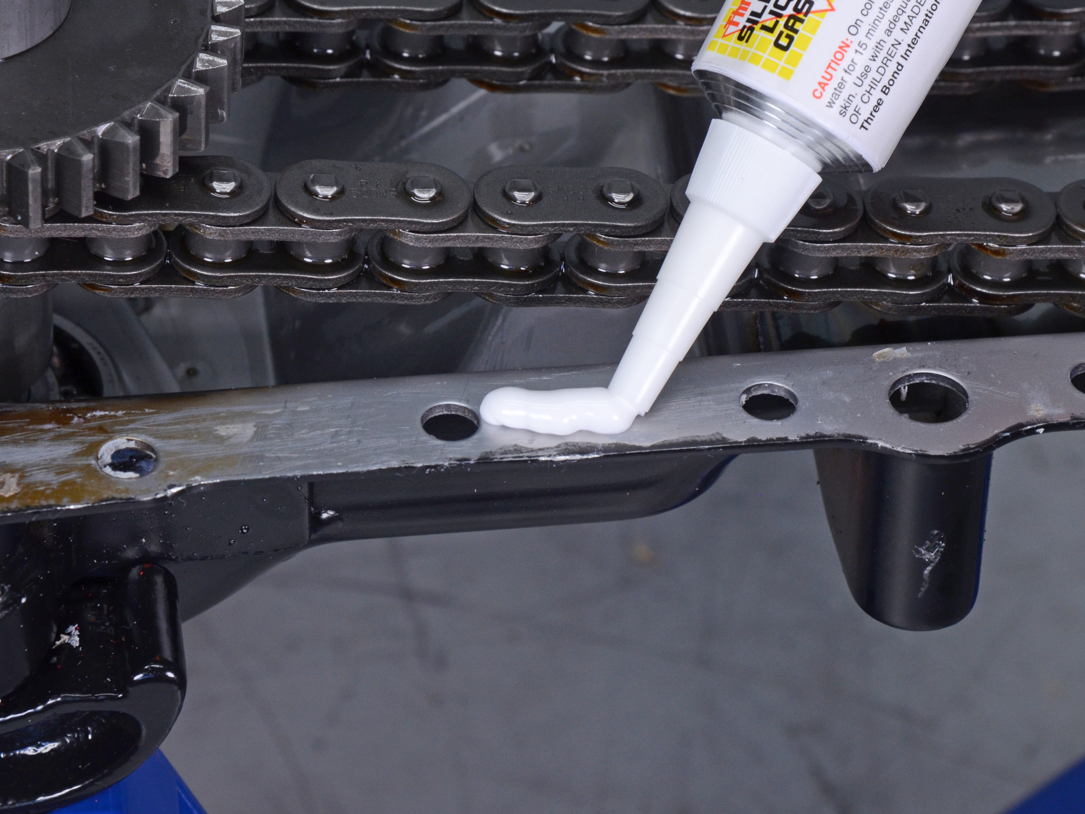

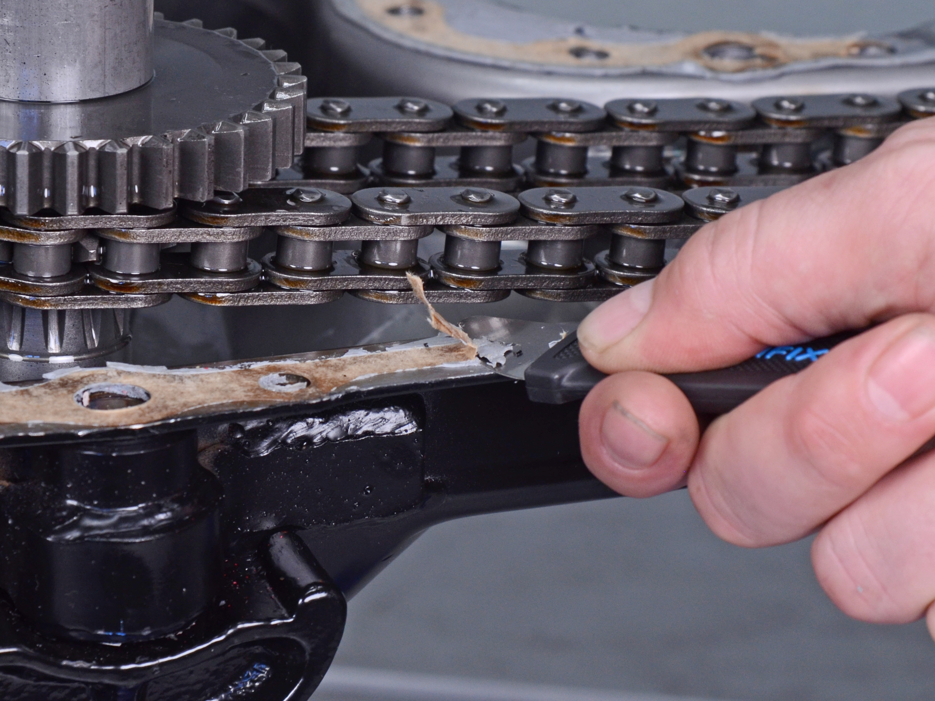

  51. Honda Rear Tine Tiller FRC800K1A P.T.O. Change Fork Replacement, Separate the two halves of the case: crwdns2935265:051crwdnd2935265:01crwdnd2935265:01crwdne2935265:0
    • Remove the thirty-two transmission case fasteners:
    • Thirty 12 mm bolts and nuts
    • Two 14 mm bolts and nuts
    • Reinstallation tip: Install five to eight 12 mm transmission case bolts equidistant around the circumference of the two halves of the case to tighten the two halves together. Once the two halves are mated, reinstall the rest of the 12 mm and the two 14 mm transmission case bolts in a criss-cross pattern.
    • Torque all transmission case bolts to 16 ft-lb (22 Nm). Re-torque all transmission case bolts after five hours. Wipe off any excess liquid gasket that squeezes out after you start tightening the two halves together.

    • Use a sharp blade to cut away any gasket material around the shift holder assembly.
    • Always cut away from yourself and others.

    • Reinstallation tip: Scrape off old gasket before putting the transmission back together. Use a Scotch-Brite pad to remove any stubborn gasket from all mating surfaces, and do a final cleaning with isopropyl alcohol.
    • Be extra cautious to not let any old gasket fall into the transmission case oil basin, as debris could potentially harm future performance.
    • Reinstallation tip: When reapplying liquid gasket to the transmission case, run a 2-4 mm bead along all gasket mating surfaces on both the left and right transmission cases. Use HondaBond 4, ThreeBond 1216, or an equivalent liquid gasket. Reassemble both transmission halves within 10 minutes of applying the liquid gasket.

  59. Honda Rear Tine Tiller FRC800K1A P.T.O. Change Fork Replacement, Remove the shift holder assembly: crwdns2935265:059crwdnd2935265:01crwdnd2935265:03crwdne2935265:0 Honda Rear Tine Tiller FRC800K1A P.T.O. Change Fork Replacement, Remove the shift holder assembly: crwdns2935265:059crwdnd2935265:02crwdnd2935265:03crwdne2935265:0 Honda Rear Tine Tiller FRC800K1A P.T.O. Change Fork Replacement, Remove the shift holder assembly: crwdns2935265:059crwdnd2935265:03crwdnd2935265:03crwdne2935265:0
    • Slowly pull the shift holder assembly away from the transmission gearing to unseat the shift forks.
    • Lift the assembly out and away from the rest of the transmission to remove.
    • Some gears are supported by the shift forks, so they may shift during removal.
    • Reinstallation tip: Ensure the three shift forks line up with each of their corresponding gear shift slots.

    • Use a 2.5 mm punch to partially remove the shift holder spring pin.
    • Leave the spring pin in the shift holder. It only needs to be pushed down enough so the spring can be removed.
  62. Honda Rear Tine Tiller FRC800K1A P.T.O. Change Fork Replacement: crwdns2935265:062crwdnd2935265:01crwdnd2935265:03crwdne2935265:0 Honda Rear Tine Tiller FRC800K1A P.T.O. Change Fork Replacement: crwdns2935265:062crwdnd2935265:02crwdnd2935265:03crwdne2935265:0 Honda Rear Tine Tiller FRC800K1A P.T.O. Change Fork Replacement: crwdns2935265:062crwdnd2935265:03crwdnd2935265:03crwdne2935265:0
    • Use needle nose pliers to remove the spring from the shift holder housing.
    • There is a #10 ball bearing securing the P.T.O. change fork in place. It is located between the retention spring and the change fork.
    • Reinstallation Tip: Each change fork is separated by two #10 steel ball bearings. If any ball bearings fall out of the shift holder assembly, ensure there are two between the PTO change fork and the middle change fork and one between the PTO change fork and the spring in the shift shaft holder passage.
