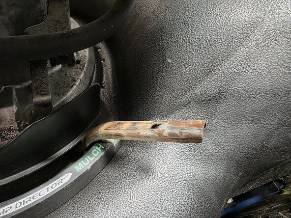

  1. Honda Lawnmower HRN216VKA Mulch/Bag Selector Latch Replacement, Remove any broken pieces: crwdns2935265:01crwdnd2935265:01crwdnd2935265:01crwdne2935265:0
    • Ensure all old pieces are removed. Clean up any debris or rust. Ensure tab is not missing or bent improperly.

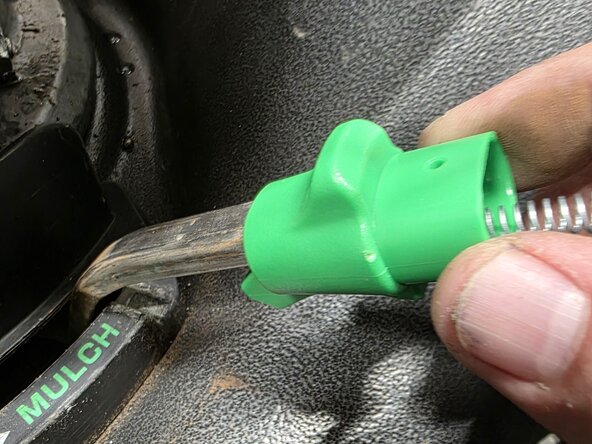

  2. Honda Lawnmower HRN216VKA Mulch/Bag Selector Latch Replacement, Prepare parts: crwdns2935265:02crwdnd2935265:01crwdnd2935265:02crwdne2935265:0 Honda Lawnmower HRN216VKA Mulch/Bag Selector Latch Replacement, Prepare parts: crwdns2935265:02crwdnd2935265:02crwdnd2935265:02crwdne2935265:0
    • Ensure your parts are all available and in working order.

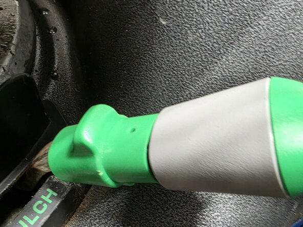

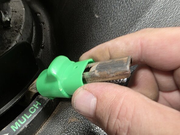

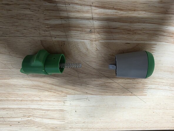

  3. Honda Lawnmower HRN216VKA Mulch/Bag Selector Latch Replacement, Assemble: crwdns2935265:03crwdnd2935265:01crwdnd2935265:03crwdne2935265:0 Honda Lawnmower HRN216VKA Mulch/Bag Selector Latch Replacement, Assemble: crwdns2935265:03crwdnd2935265:02crwdnd2935265:03crwdne2935265:0 Honda Lawnmower HRN216VKA Mulch/Bag Selector Latch Replacement, Assemble: crwdns2935265:03crwdnd2935265:03crwdnd2935265:03crwdne2935265:0
    • Insert lower latch first.
    • Insert spring

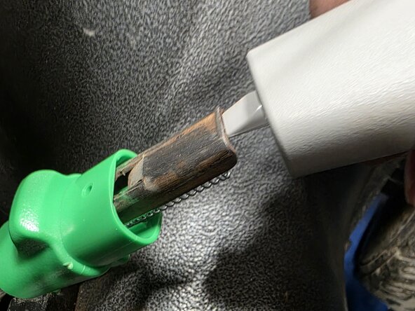

    • Insert top latch.
  4. Honda Lawnmower HRN216VKA Mulch/Bag Selector Latch Replacement, Complete Assembly and Check: crwdns2935265:04crwdnd2935265:01crwdnd2935265:01crwdne2935265:0
    • Line up top latch and press in firmly aligning up spring and lower latch until catch locks into tab.
    • Verify functionality of new part.
