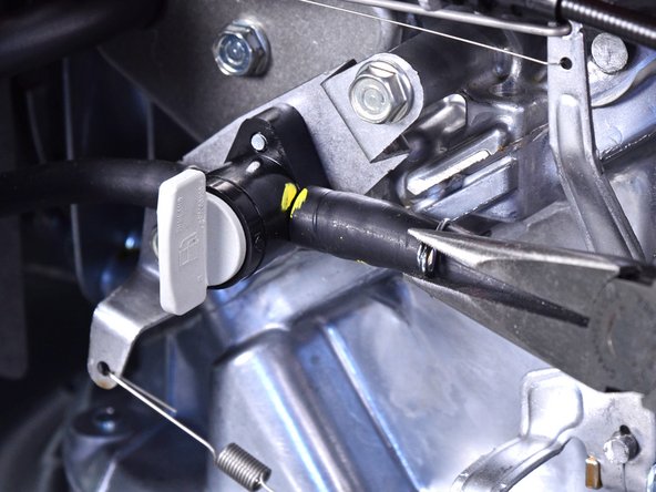

  3. Honda Lawn Mower HRS216K6 PKAA Flywheel Replacement, Disconnect the fuel tank: crwdns2935265:03crwdnd2935265:01crwdnd2935265:03crwdne2935265:0 Honda Lawn Mower HRS216K6 PKAA Flywheel Replacement, Disconnect the fuel tank: crwdns2935265:03crwdnd2935265:02crwdnd2935265:03crwdne2935265:0 Honda Lawn Mower HRS216K6 PKAA Flywheel Replacement, Disconnect the fuel tank: crwdns2935265:03crwdnd2935265:03crwdnd2935265:03crwdne2935265:0
    • Use needle nose pliers to compress and slide the tube clamp away from the cutoff valve's fitting.
  4. Honda Lawn Mower HRS216K6 PKAA Flywheel Replacement: crwdns2935265:04crwdnd2935265:01crwdnd2935265:02crwdne2935265:0 Honda Lawn Mower HRS216K6 PKAA Flywheel Replacement: crwdns2935265:04crwdnd2935265:02crwdnd2935265:02crwdne2935265:0
    • Residual fuel may leak out of this hose. Be ready to catch any spillage.
    • Disconnect the fuel line from the cutoff valve.

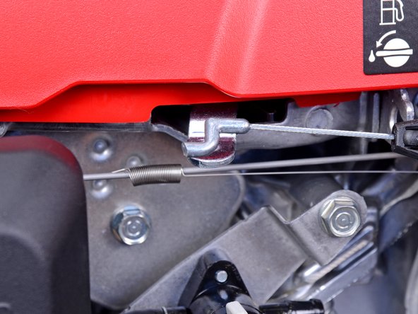

  5. Honda Lawn Mower HRS216K6 PKAA Flywheel Replacement, Disconnect the brake cable: crwdns2935265:05crwdnd2935265:01crwdnd2935265:01crwdne2935265:0
    • Use needle nose pliers to squeeze the two locking tabs on the brake cable latch.
  6. Honda Lawn Mower HRS216K6 PKAA Flywheel Replacement: crwdns2935265:06crwdnd2935265:01crwdnd2935265:03crwdne2935265:0 Honda Lawn Mower HRS216K6 PKAA Flywheel Replacement: crwdns2935265:06crwdnd2935265:02crwdnd2935265:03crwdne2935265:0 Honda Lawn Mower HRS216K6 PKAA Flywheel Replacement: crwdns2935265:06crwdnd2935265:03crwdnd2935265:03crwdne2935265:0

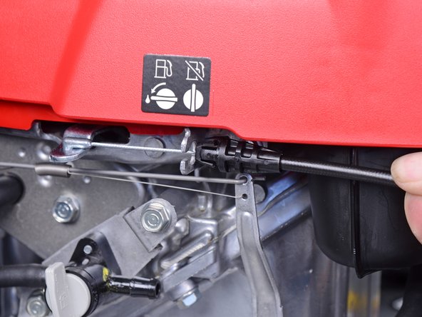

    • Pull to unlatch the cable sheath.
    • Pull the brake cable away from the motor.

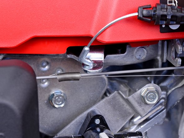

  7. Honda Lawn Mower HRS216K6 PKAA Flywheel Replacement: crwdns2935265:07crwdnd2935265:01crwdnd2935265:03crwdne2935265:0 Honda Lawn Mower HRS216K6 PKAA Flywheel Replacement: crwdns2935265:07crwdnd2935265:02crwdnd2935265:03crwdne2935265:0 Honda Lawn Mower HRS216K6 PKAA Flywheel Replacement: crwdns2935265:07crwdnd2935265:03crwdnd2935265:03crwdne2935265:0
    • Push the cable towards the cable anchor to give it enough slack to be removed.
    • Remove the brake cable from the motor.
