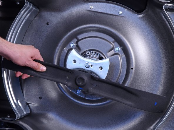

  16. Honda Lawn Mower HRS216K6 PKAA Crankshaft Replacement, Remove the blade: crwdns2935265:016crwdnd2935265:01crwdnd2935265:01crwdne2935265:0
    • Loosen, but don't remove, the shiny 14 mm blade holder bolt.
    • Remove the two matte 14 mm bolts securing the blade to the blade holder.
  17. Honda Lawn Mower HRS216K6 PKAA Crankshaft Replacement: crwdns2935265:017crwdnd2935265:01crwdnd2935265:02crwdne2935265:0 Honda Lawn Mower HRS216K6 PKAA Crankshaft Replacement: crwdns2935265:017crwdnd2935265:02crwdnd2935265:02crwdne2935265:0
    • Remove the blade.
    • If the blade is heavily used, it may be sharp in some areas. If this is the case, use gloves to remove it.

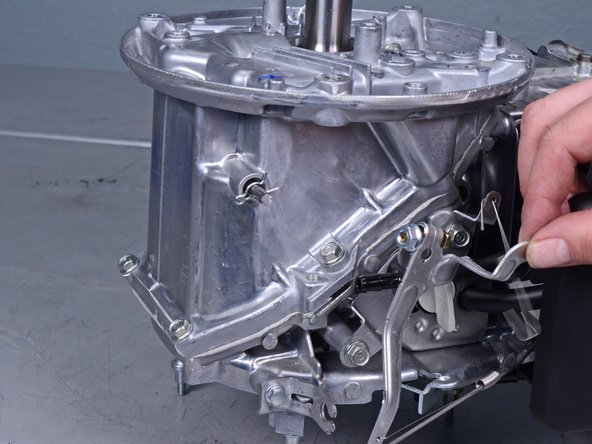

  20. Honda Lawn Mower HRS216K6 PKAA Crankshaft Replacement, Remove the motor: crwdns2935265:020crwdnd2935265:01crwdnd2935265:01crwdne2935265:0
    • Remove the four 12 mm bolts securing the motor to the frame.
    • Once these bolts are removed, the engine will be free to fall off the mower frame. If you are removing the bolts while the mower is on its side, you may need another person to steady the motor.
  21. Honda Lawn Mower HRS216K6 PKAA Crankshaft Replacement: crwdns2935265:021crwdnd2935265:01crwdnd2935265:02crwdne2935265:0 Honda Lawn Mower HRS216K6 PKAA Crankshaft Replacement: crwdns2935265:021crwdnd2935265:02crwdnd2935265:02crwdne2935265:0
    • Lift the engine off of the mower frame and remove it.
  22. Honda Lawn Mower HRS216K6 PKAA Crankshaft Replacement, Flip the motor over: crwdns2935265:022crwdnd2935265:01crwdnd2935265:01crwdne2935265:0
    • Flip the motor over such that it's resting on the three mounting posts for the fan cover.

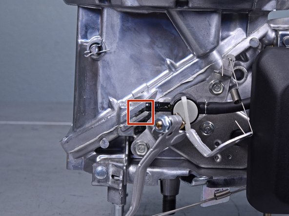

  23. Honda Lawn Mower HRS216K6 PKAA Crankshaft Replacement, Remove the governor arm: crwdns2935265:023crwdnd2935265:01crwdnd2935265:01crwdne2935265:0
    • Loosen, but don't remove, the 10 mm bolt securing the governor arm to the motor.
  24. Honda Lawn Mower HRS216K6 PKAA Crankshaft Replacement: crwdns2935265:024crwdnd2935265:01crwdnd2935265:03crwdne2935265:0 Honda Lawn Mower HRS216K6 PKAA Crankshaft Replacement: crwdns2935265:024crwdnd2935265:02crwdnd2935265:03crwdne2935265:0 Honda Lawn Mower HRS216K6 PKAA Crankshaft Replacement: crwdns2935265:024crwdnd2935265:03crwdnd2935265:03crwdne2935265:0
    • Remove the governor arm from the mounting post.
    • Don't completely remove the governor arm. It's still connected to the motor with some springs.
    • Set the governor arm aside.

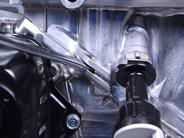

  26. Honda Lawn Mower HRS216K6 PKAA Crankshaft Replacement: crwdns2935265:026crwdnd2935265:01crwdnd2935265:02crwdne2935265:0 Honda Lawn Mower HRS216K6 PKAA Crankshaft Replacement: crwdns2935265:026crwdnd2935265:02crwdnd2935265:02crwdne2935265:0
    • Loosen the oil pan by inserting a flathead screwdriver in the two recessed access points on either side of the engine block.
  27. Honda Lawn Mower HRS216K6 PKAA Crankshaft Replacement: crwdns2935265:027crwdnd2935265:01crwdnd2935265:02crwdne2935265:0 Honda Lawn Mower HRS216K6 PKAA Crankshaft Replacement: crwdns2935265:027crwdnd2935265:02crwdnd2935265:02crwdne2935265:0
    • Use a flathead screwdriver to pry the case apart.
    • Work your way around the entire mating surface to loosen the oil pan.
    • Any residual engine oil may start to leak out. Be ready to contain any spillage.

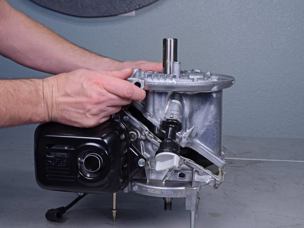

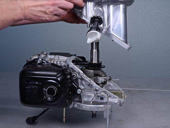

  28. Honda Lawn Mower HRS216K6 PKAA Crankshaft Replacement: crwdns2935265:028crwdnd2935265:01crwdnd2935265:03crwdne2935265:0 Honda Lawn Mower HRS216K6 PKAA Crankshaft Replacement: crwdns2935265:028crwdnd2935265:02crwdnd2935265:03crwdne2935265:0 Honda Lawn Mower HRS216K6 PKAA Crankshaft Replacement: crwdns2935265:028crwdnd2935265:03crwdnd2935265:03crwdne2935265:0
    • Lift the oil pan straight up and remove it.
    • Any residual engine oil may leak out. Be ready to contain any spillage.
    • Before reassembly, clean off old liquid gasket from the engine block mating surfaces thoroughly before applying new HondaBond or equivalent liquid gasket.
    • During reassembly, loosely tighten each flange bolt and then tighten center-out to 9 ft-lb (12 N-m).
    • Wait at least 20 minutes after reassembly before adding oil to the engine.

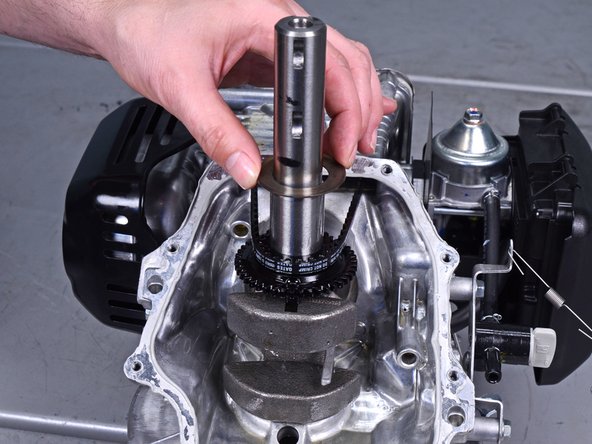

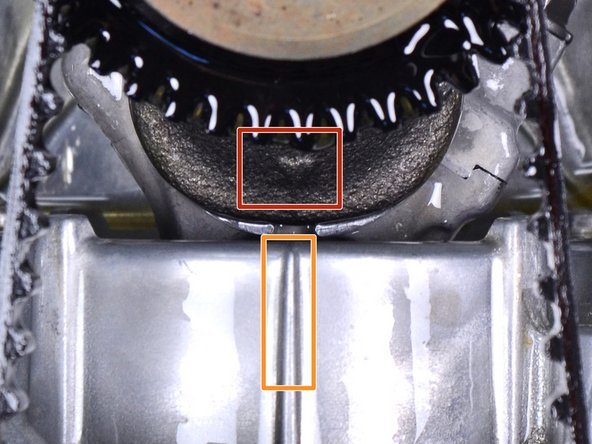

  29. Honda Lawn Mower HRS216K6 PKAA Crankshaft Replacement, Position the piston: crwdns2935265:029crwdnd2935265:01crwdnd2935265:02crwdne2935265:0 Honda Lawn Mower HRS216K6 PKAA Crankshaft Replacement, Position the piston: crwdns2935265:029crwdnd2935265:02crwdnd2935265:02crwdne2935265:0
    • Rotate the crankshaft by hand to position the piston at top dead center (TDC) by aligning the two marks:
    • The arrow on the crankshaft
    • The seam on the cylinder block
  30. Honda Lawn Mower HRS216K6 PKAA Crankshaft Replacement, Remove the crankshaft: crwdns2935265:030crwdnd2935265:01crwdnd2935265:02crwdne2935265:0 Honda Lawn Mower HRS216K6 PKAA Crankshaft Replacement, Remove the crankshaft: crwdns2935265:030crwdnd2935265:02crwdnd2935265:02crwdne2935265:0
    • Remove the thrust washer.
    • Note the orientation of the washer—it only goes on one way.
  31. Honda Lawn Mower HRS216K6 PKAA Crankshaft Replacement: crwdns2935265:031crwdnd2935265:01crwdnd2935265:01crwdne2935265:0

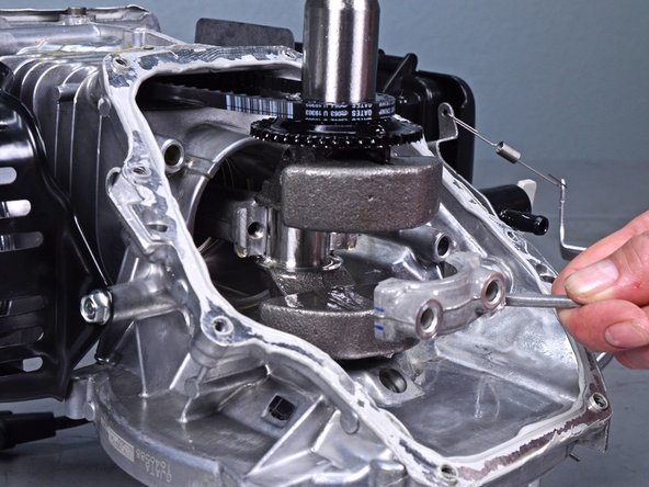

    • Remove the two 10 mm bolts securing the end cap to the connecting rod.
  32. Honda Lawn Mower HRS216K6 PKAA Crankshaft Replacement: crwdns2935265:032crwdnd2935265:01crwdnd2935265:02crwdne2935265:0 Honda Lawn Mower HRS216K6 PKAA Crankshaft Replacement: crwdns2935265:032crwdnd2935265:02crwdnd2935265:02crwdne2935265:0
    • Remove the connecting rod end cap.
  33. Honda Lawn Mower HRS216K6 PKAA Crankshaft Replacement: crwdns2935265:033crwdnd2935265:01crwdnd2935265:02crwdne2935265:0 Honda Lawn Mower HRS216K6 PKAA Crankshaft Replacement: crwdns2935265:033crwdnd2935265:02crwdnd2935265:02crwdne2935265:0

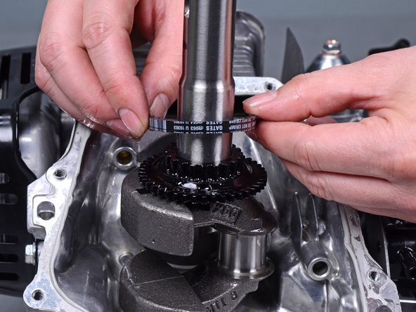

    • Slip the timing belt off of the timing pulley on the crankshaft.
  34. Honda Lawn Mower HRS216K6 PKAA Crankshaft Replacement: crwdns2935265:034crwdnd2935265:01crwdnd2935265:02crwdne2935265:0 Honda Lawn Mower HRS216K6 PKAA Crankshaft Replacement: crwdns2935265:034crwdnd2935265:02crwdnd2935265:02crwdne2935265:0

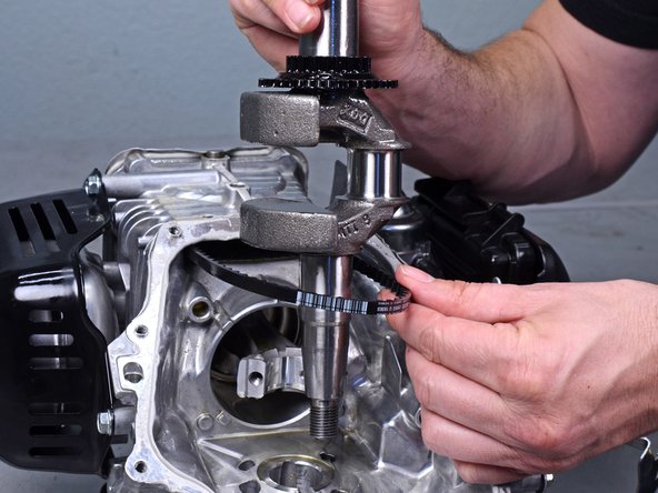

    • Pull the crankshaft directly up and out until it's restricted by the timing belt.
    • This shouldn't require much force—don't stretch the timing belt.
  35. Honda Lawn Mower HRS216K6 PKAA Crankshaft Replacement: crwdns2935265:035crwdnd2935265:01crwdnd2935265:03crwdne2935265:0 Honda Lawn Mower HRS216K6 PKAA Crankshaft Replacement: crwdns2935265:035crwdnd2935265:02crwdnd2935265:03crwdne2935265:0 Honda Lawn Mower HRS216K6 PKAA Crankshaft Replacement: crwdns2935265:035crwdnd2935265:03crwdnd2935265:03crwdne2935265:0
    • Slip the timing belt around the counterweights on the crankshaft.
    • The other side of the timing belt is connected to the cam pulley inside of the cylinder head. It can slip off during this step. If it does, peer up into the cylinder head and reseat the timing belt on the cam pulley.
  36. Honda Lawn Mower HRS216K6 PKAA Crankshaft Replacement: crwdns2935265:036crwdnd2935265:01crwdnd2935265:01crwdne2935265:0
    • With the crankshaft free of the timing belt, remove it from the motor.

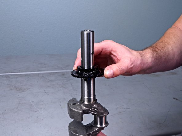

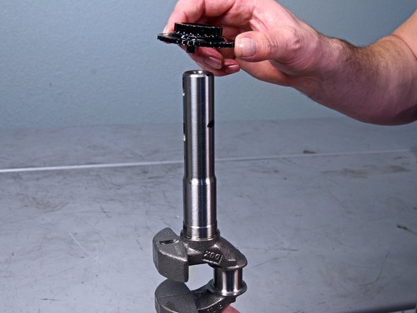

  37. Honda Lawn Mower HRS216K6 PKAA Crankshaft Replacement, Remove the timing pulley: crwdns2935265:037crwdnd2935265:01crwdnd2935265:03crwdne2935265:0 Honda Lawn Mower HRS216K6 PKAA Crankshaft Replacement, Remove the timing pulley: crwdns2935265:037crwdnd2935265:02crwdnd2935265:03crwdne2935265:0 Honda Lawn Mower HRS216K6 PKAA Crankshaft Replacement, Remove the timing pulley: crwdns2935265:037crwdnd2935265:03crwdnd2935265:03crwdne2935265:0
    • Remove the timing pulley from the crankshaft.
