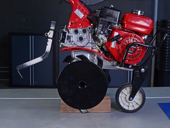

  2. Honda FC600 Tiller Tine Replacement, Prop Up the Tiller: crwdns2935265:02crwdnd2935265:01crwdnd2935265:01crwdne2935265:0
    • The next two steps demonstrate how to prop up the tiller to work on the tines.
    • Set down a block (or blocks) of wood onto your work surface.
    • Make sure the wood blocks are narrow enough to fit in between the left- and right-side tines.

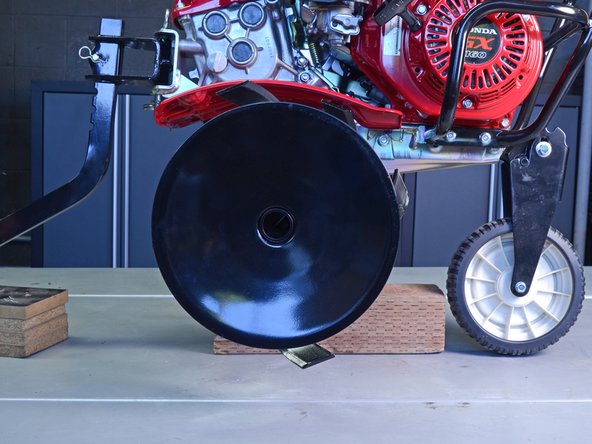

    • Lift and roll the tiller over the wood block until the center of the tine axle is hovering over the wood block.
    • Gently set the tiller down so that the center of the tine axle rests on the wood block.
    • You may need to lean the tiller to one side to make sure the tines on the other side are completely off the work surface.

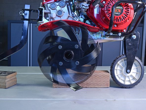

  4. Honda FC600 Tiller Tine Replacement: crwdns2935265:04crwdnd2935265:01crwdnd2935265:01crwdne2935265:0
    • Place a block (or blocks) of wood under the tiller's drag bar to prevent the tiller from leaning back.

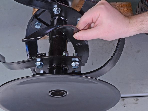

    • Remove the two 14 mm nuts securing the tine to the mounting bracket.
    • It is not required to remove the side disc.
    • Depending on which tine you're replacing, you may need to remove different nuts.
  6. Honda FC600 Tiller Tine Replacement: crwdns2935265:06crwdnd2935265:01crwdnd2935265:02crwdne2935265:0 Honda FC600 Tiller Tine Replacement: crwdns2935265:06crwdnd2935265:02crwdnd2935265:02crwdne2935265:0
    • Grab the tine and pull it straight off of the mounting bracket.
    • Removing the bolts is not required.
