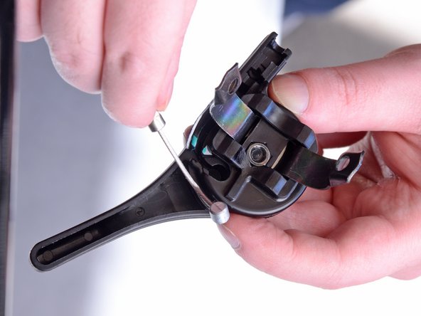

  4. Honda FC600 Tiller Throttle Lever Replacement, Remove the Small Throttle Cable Clip: crwdns2935265:04crwdnd2935265:01crwdnd2935265:02crwdne2935265:0 Honda FC600 Tiller Throttle Lever Replacement, Remove the Small Throttle Cable Clip: crwdns2935265:04crwdnd2935265:02crwdnd2935265:02crwdne2935265:0
    • Use a pair of needle-nose pliers to remove the small clip attached to the throttle cable.

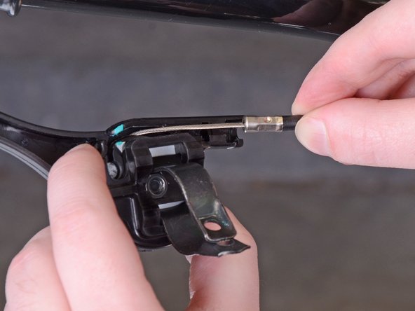

  5. Honda FC600 Tiller Throttle Lever Replacement, Remove the Throttle Cable: crwdns2935265:05crwdnd2935265:01crwdnd2935265:02crwdne2935265:0 Honda FC600 Tiller Throttle Lever Replacement, Remove the Throttle Cable: crwdns2935265:05crwdnd2935265:02crwdnd2935265:02crwdne2935265:0
    • Grab the open end of the throttle cable and pull it out of the throttle lever to free it from its recess.
  6. Honda FC600 Tiller Throttle Lever Replacement: crwdns2935265:06crwdnd2935265:01crwdnd2935265:03crwdne2935265:0 Honda FC600 Tiller Throttle Lever Replacement: crwdns2935265:06crwdnd2935265:02crwdnd2935265:03crwdne2935265:0 Honda FC600 Tiller Throttle Lever Replacement: crwdns2935265:06crwdnd2935265:03crwdnd2935265:03crwdne2935265:0
    • Continue to lift the throttle cable out of the throttle lever, making sure it clears the openings in the recess.
